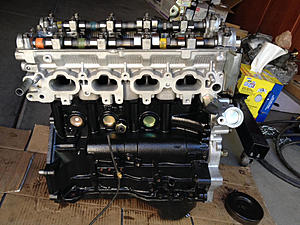

Added short block pics - more to come (these are approx a week old)

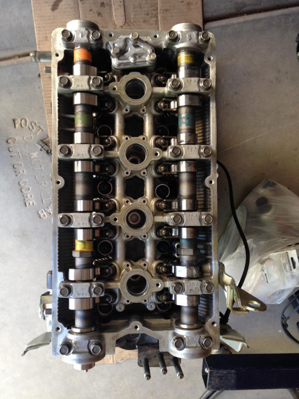

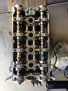

She lives! We ended up dropping in the rebuilt block while we waited for the FP green to come in (shipping today or tomorrow) so I could break in the engine. 1400 miles later and she runs like a top! Had her dynoed a couple weeks back to see where she sits before we finish up the build. As she sits now I have the 2.3l , pistons, rods, cams, springs/retainers, and clutch installed. Everything else is back to stock with a baseline tune. Here are some photos and the dyno sheet.
276whp/282wtq
