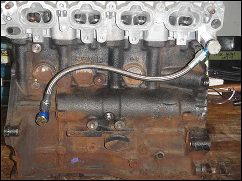

I'm still not sure where this mivec oil line is can someone post a picture?

That's the back of the block looking at intake side of the head, so left is towards trans and right is passenger side. Yours is a greenish hardline though not a stainless line.

Oh banjo guys. So is this it?
What do I need to move to fully inspect this and where are the other mivec components located? Like filter, solenoid, Ocv etc?

Yup that banjo is one end, the filter should be in that end, the banjo unscrews from the hex fitting it's in then the hex fitting is threaded in so that will unscrew too. The filter is a conical shaped metal screen in there, but you shouldn't have to unscrew the hex fitting, just the banjo bolt. Once that is out the filter is inside the hex fitting. As for the solenoid, that's the thing right above the banjo in your pic with the red yellow wire running to the connector with 2 wires. And ocv, that guy is the banjo bolt at the other end of the line, looks like a banjo bolt but the inside is actually a check valve. If you have the service manual the whole system is on page 35 of section 11B.
