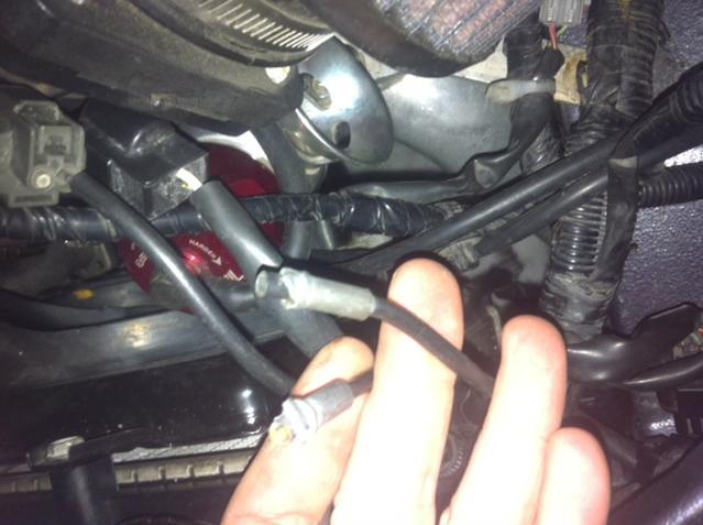

Honestly, I can't really remember how it died. It happened rather quickly and took me by surprise. It may have sputtered like once but it definitely just died. It didn't sound like engine damage. I'm almost certain it didn't sputter it's way to dying. Maybe like once or twice then she was done.
1. I had just about a 1/4 tank of 6 ish month old summer 93 in the tank and then I added Seafoam when she was running initially. After she died I added about 3 ish gallons of fresh winter 92/93 in and bumped it up to just about 1/2 tank.
Regarding fuel, I can prime the pump using the actuator in evoscan, does this rule out relays/etc? I don't hear the pump with the key in the "on" position but I keep reading 50/50 that it does/doesnt. Also with the return fuel line off it spat out fuel when cranking and I believe I see fresh fuel bc I just noticed an injector o-ring leak. Nothing serious but will get replaced.
2. To check if it's clogged I just pull the rear seat correct? Similar to a DSM? (I'll just do a quick search)
3. My steering wheel column was ripped apart because when the airbag went off it basically made the steering wheel flop around bc it broke whatever holds it into place (literally could move the steering wheel to the left/right/in/out/ up/down, etc)
Minus the headlight connector and turn signal connectors everything else was in place. I tried pushing the sensor to the ignition switch (i think, sensor on the left side of the steering wheel) in to ensure it was connected and that didn't change anything. But now come to think of it awhile back 1/2 my dash stopped illuminating and then I hit a railroad track and it came back on so definitely was a short somewhere. The dash appeared to illuminate just fine though. Not that I'm ruling it out.
Today I picked up the car from the shop (had to replace that ACD hardline) and noticed my key fob didnt work anymore, and the lights were barely on. I cam across a split wire that I didnt see before and when I went to move it there was an arc on the core support. So if I'm super lucky I'm hoping that when I dropped it from the jacks I caused it to move and short out something in the ignition system. Also another theory I have is that the few times I revved it that I sent more load causing an arc to run thru a disconnected ground because I am fairly certain that ground near the exhaust cam wasn't broken when she was running and I don't know how else that would've happened.
I'm going to get a charge on that battery and solder the broken wire and attempt to start her. If she doesn't start then I'll check the fuel filter, and pull the plastic wire shielding off a couple parts of the wiring harness.
My luck sucks, and I wish electrical wasn't a pain in the A@* to troubleshoot/diagnose or I just never get the easy electrical issues.

It isn't the cut wire. I soldered it today and still a no go. I replaced the exhaust cam sensor as well and no luck. I'm waiting for the intake cam sensor to come in. If that's not it then I'll go ahead and rip apart the wiring harness to check for fried wires and then move onto the CAS. I'm about 4k away from a timing belt job so I might as well get that taken care of as well.
