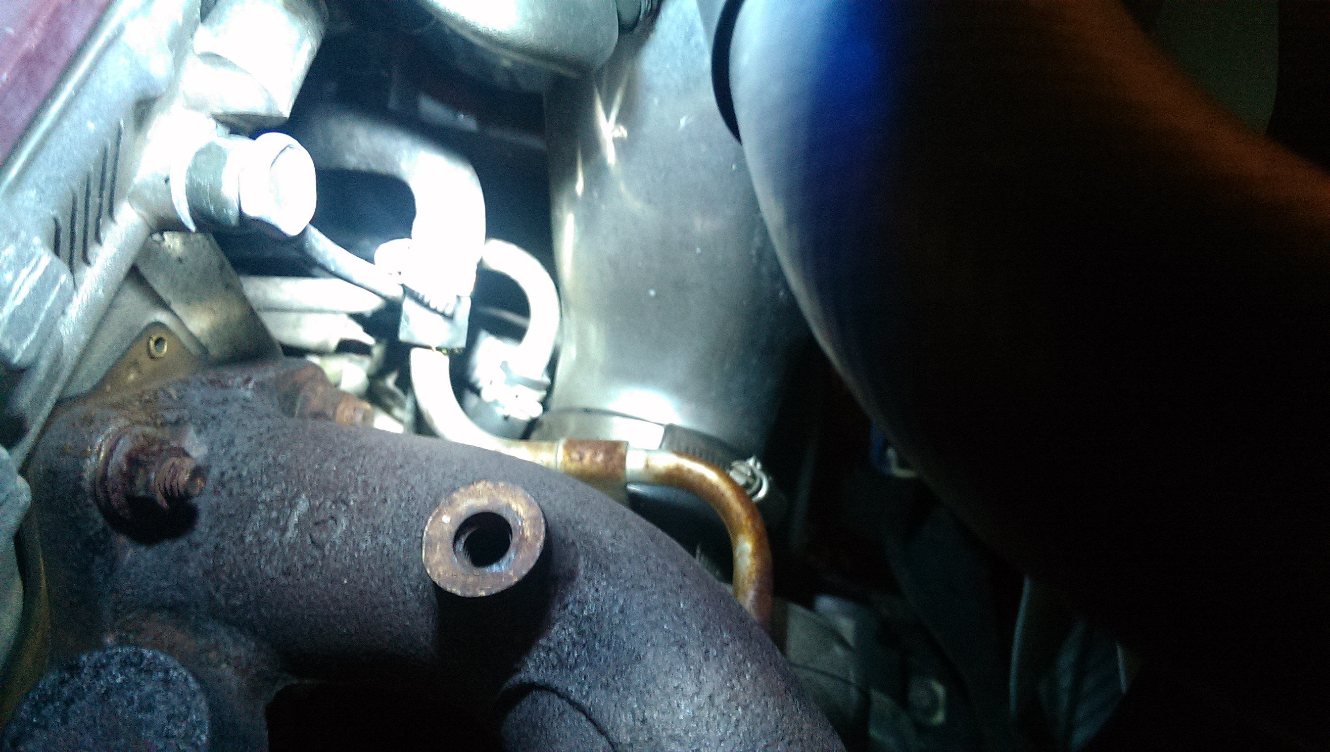

Coolant was fairly low.
Refilled and took out for a test drive.
Opened the hood back up and there is some white smoke and coolant visible just above the turbo/intake.

Will get some better pictures when my phone charges so I can use the flash and not a flash light

the steam could be from anything you spilled evaporating. if not, you may have a leak on your water feed or return line. i'm guessing, as i can't see pictures at work.

With the car off gently squeeze all rubber coolant hoses. Rudimentary way of sourcing the leak. Chances are you have hairline break which looks sealed but cracks open when under pressure. Good luck.
