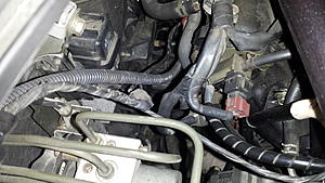

hello I recently got my engine back and me and my dad started to installed it and we are missing this plugs. The car wont turn over and we do not hear the fuel pump engaging.we tested the fuel pump and it works. please help thank you

Something doesnt look right. That metal tab sticking out of one of those pig tails is suppose to be part of a sensor.

Those look like the two connectors that go to the throttle body and the one with the metal tab looks like the connector for the oil pressure switch.

I think those are 16 17 18 19 from the diagram

None of those use a spring clip like 8 though. It looks like 8, 9, and 19? maybe. I only see 3 connectors in the op's picture

took a look at my car, you are missing the controller for the fuel pressure regulator. See attached pic.

thanks everyone for the help I manage to find the problem. the car started and now the oil pump is not working greattt... thanks everyone love this forum always so helpful! just seems like one problem after the other

One of those is your oil pressure switch, so that could be why the oil pump isn't working. And I forgot what the stock fpr connector looked like haha, good call Biggiesacks.
