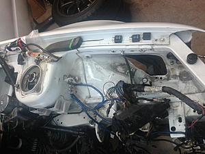

also added some photos of what ive been doing to the car
Drivers side finished
-hide fuse box
-re run brake master wires
-general clean and tidy
Passenger side work in progress
-remove abs plugs and hid under unit
-put fusebox under guard
-start cleaning
-(have a polished overflow tank to go on this side)
-Battery will be relocated to the boot
