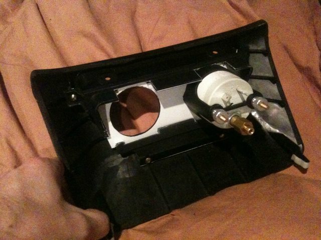

Problem is that you can't angle them upwards much without having to trim the lower cubby, something i didn't want to do.
Angling them upwards would also hide more of the top of the gauge and would make them near useless
Here's an image of the back. I used the stock cubby and trimmed it so that I could just use the mounting points from it (you can see the top and bottom section are separate). I then glued it to a flat piece of 1/8" plastic that had been spray painted and used some other pieces of plastic to "level off" the face so that it sat flush with the opening

Yeah, that looks awesome. I'm going to have to try that idea!
I was thinking that too, if doing them on an angle if it would hide the gauge a little bit.
Nicely done!!
