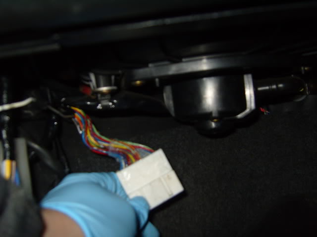

check the wiring connectors in the front footwell both sides behind the plastic kick panels
