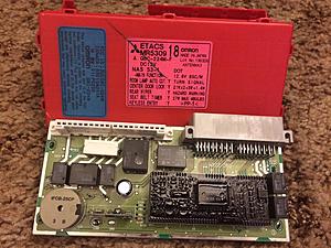

After spending several hours reading other posts and forums, i have suspected that i have recently fried my EATCS ECU. I have a few questions but ill give a little background first to let you know what happened and why i suspect a fried ETACS.
I was replacing the ignition ring connector on my 03 Evo8 GSR, as it had broken and caused the key FOB to stop working. Unfortunately i wasn't thinking and pulled a noob mistake by not disconnecting the battery prior to cutting the cable on the light to the light ring.
After cutting that light wire the car instantly went crazy, horn constantly blaring all signals on and the back wiper going back and forth. After disconnecting the battery and then the horn i tried reconnecting the battery... Signals still on outside and in the car, key fobs don't work and neither do automatic locks. After starting the car (completely fine), the back windshield starts spraying fluid.

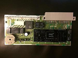

I've taken the time to take it out of the car and take it apart to check if its fried, but didn't visually see anything that would indicate it has any problems. I have attached some images of my ETACS taken part.

Does anyone else think that this is a fried ETACS based on the picures and/or the symptons?

Yes, my opinion is that it is the etacs, replace it and you should be good to go. The 530918 will work exactly the same as the 8637A014. Just get the one that's cheaper and reprogram your key fobs after it's done.
