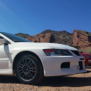

A little before picture. Looks wont change much outside. Its the internals that matter
