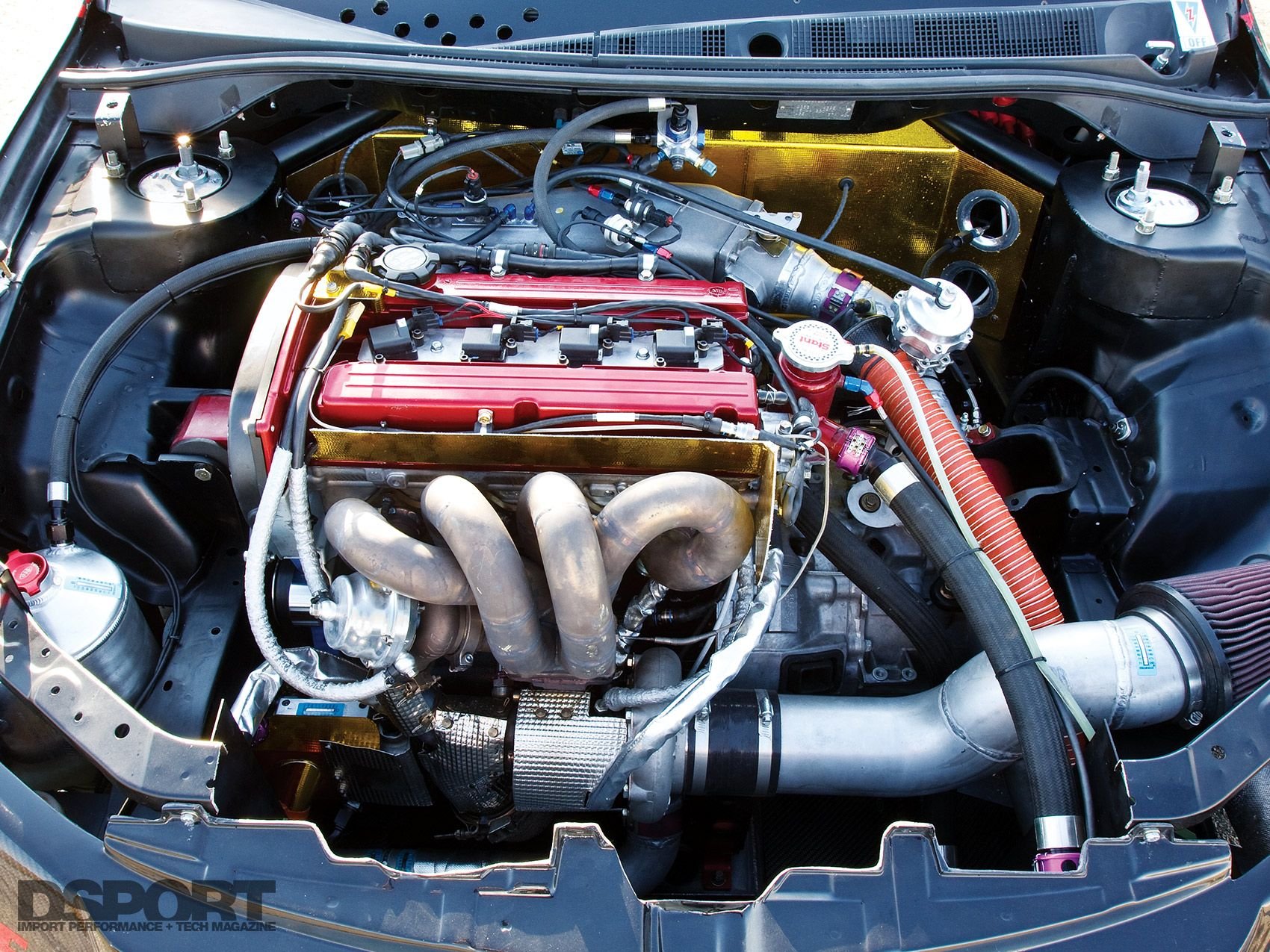

As a professional racing team, SSE left little to chance in the quest for time- attack domination. Cosworth Racing’s many years of involvement with a wide variety of motorsports made them a logical source for a powerplant. In the process, they received an added bonus: the technical advice of the team at Cosworth Racing USA. The engine build started with a brand new 4G63 shortblock, complete with Cosworth forged-steel rods, forged-aluminum pistons and stroker crankshaft. This combination increased the displacement of the EVO VIII to 2,235cc. To make the most of the added displacement, a higher- flowing Cosworth CNC-ported, big-valve cylinder head was mated to the 4G63 block.
Taking advantage of the increased displacement, a Garrett GT3582R turbocharger was chosen to provide boost pressure. Relative to the stock turbocharger, the larger GT35R turbo would ordinarily create more boost at the expense of additional lag. However, thanks to the added displacement, this large turbo still provides adequate response.
