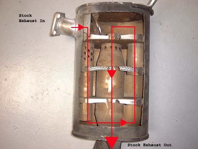

So maybe under hard acceleration, that valve opens up and short cuts the exit point?
Yes I think so too. This is what the OP on another forum said in his post where I found that picture of the muffler cutout:
"EVOs, F430s, and E46 BMW AFAIK have them."
"EVO muffler cutaway: Flapper is in the upper left. The arrows show the flow while flapper is closed. When it opens it bypasses the circuitous route."
Here is the link to the original post on the miataturbo.net forum:
https://www.miataturbo.net/diy-turbo...e-62488/page2/

I believe I remember reading that the 8 and 9 OEM mufflers are different. The 9 has a deeper growl. Maybe I’ll see if I can find something to support that, but I’m fairly certain that is the case.
“A redesigned muffler... enhances the exhaust note at low to mid-range engine speeds.”
