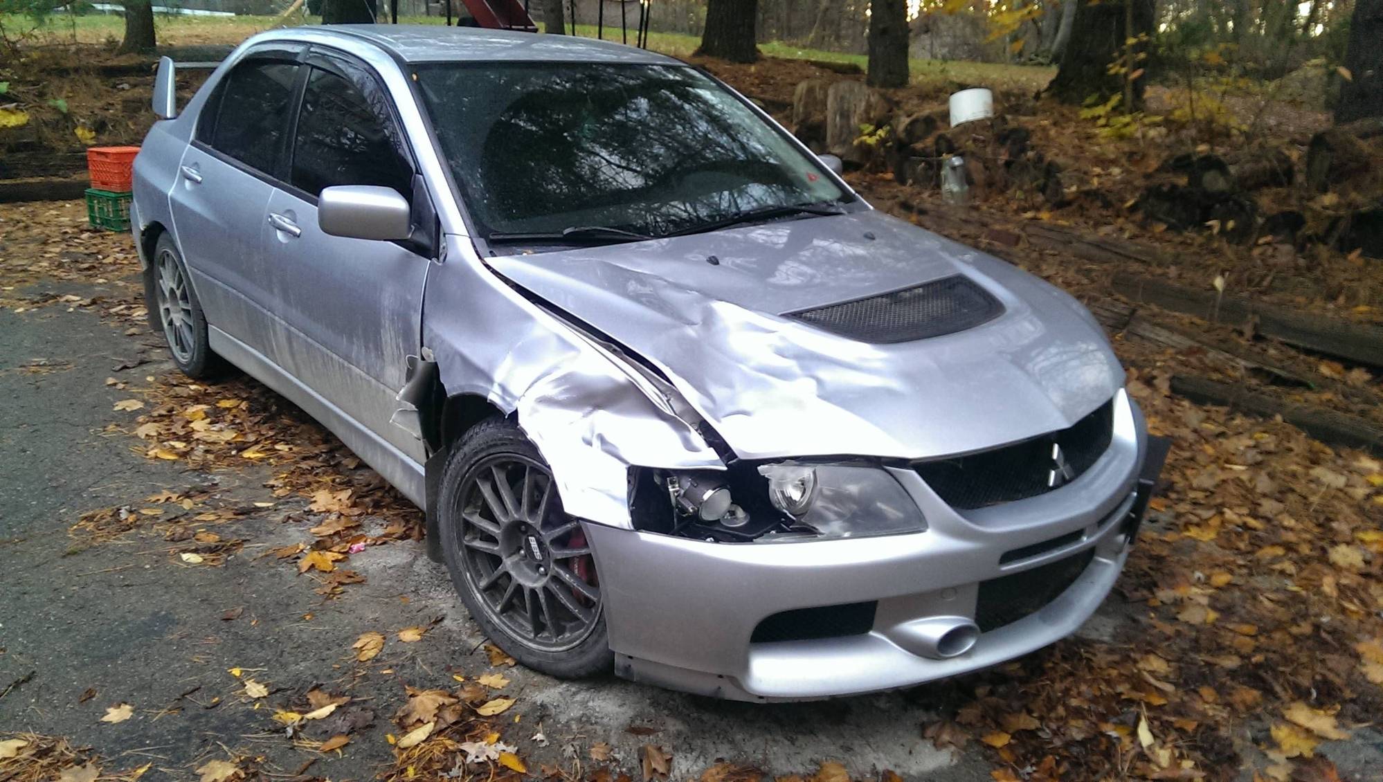

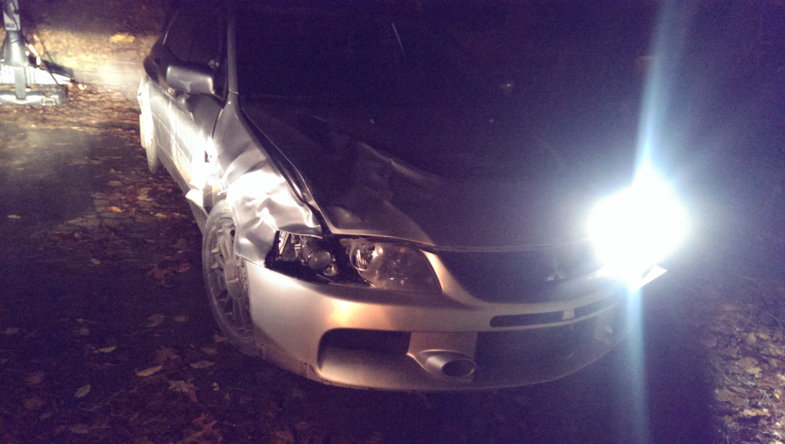

So on my way back home tonight
a deer popped in front of me.
Tried to avoid it as much as possible,
But was on the expressway going 71-72.
I veered left and hit it with my passenger headlights
Impact speed was around 45 (thanks brembos)
Even damaged my rear bumper somehow?
Sad sad day no issues in 6 years of ownership.
Never had to go through insurance before,
Any advice?
Edit:
Sigh... Forgot I recently just switched my full coverage to liability.
I was ready to put the car in the garage for winter too.
Everything will be out of pocket. What's most cost effective way to fix my car?

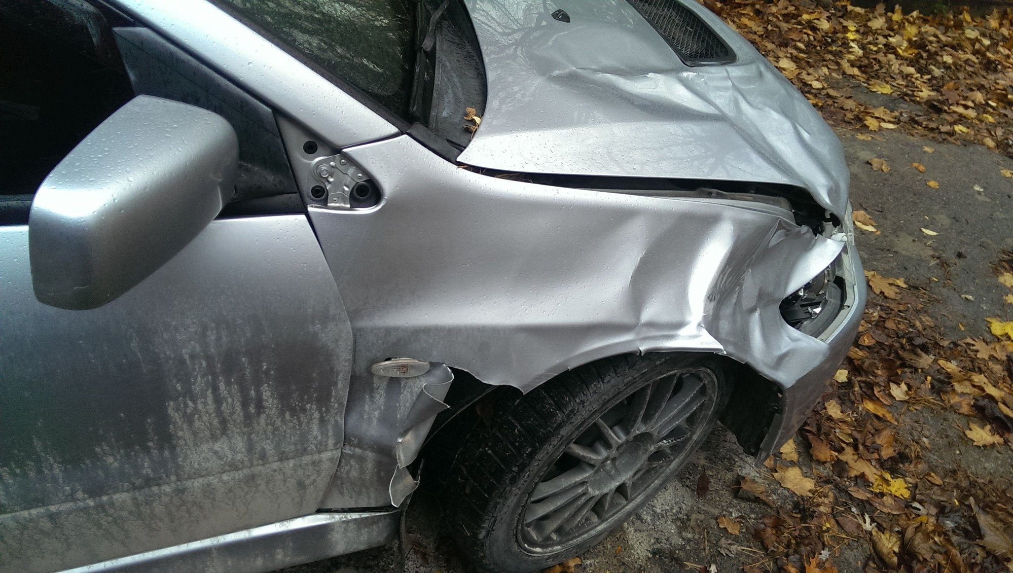

From my quick look over these are the damages:
Passenger fender
Headlight
Rear bumper
And this frame needs to be straightened

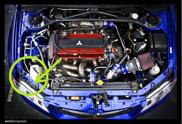

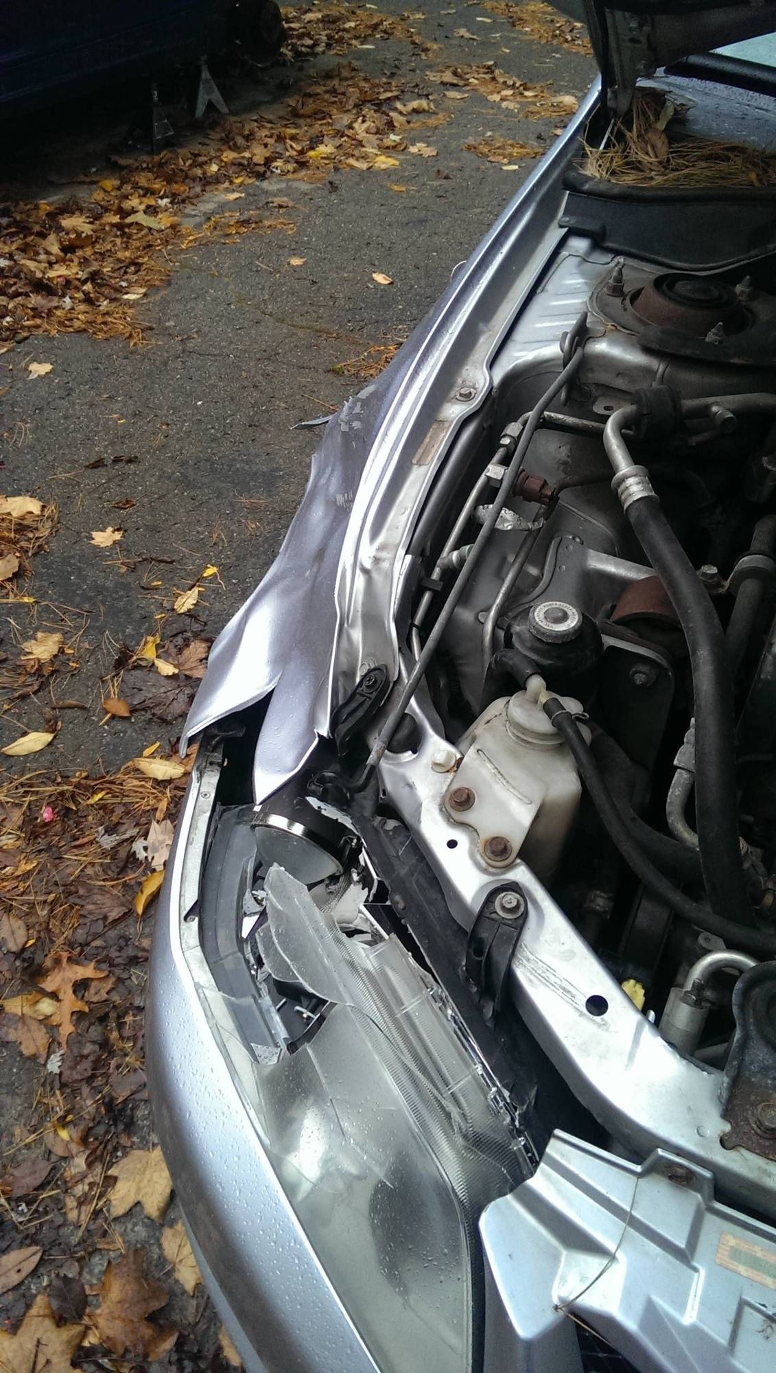

that is the radiator support, no big deal. this is about 5-7k depending on when the sheet metal comes off the car. my father owns a tier 1 body shop just to support my numbers

Its mostly gonna be prep and paint work that generates the bulk of the labor bill. You can source the panels yourself though since parts from the OEM will be $$$$. You wont have to worry about color since you will be repainting everything anyway. Replacing the radiator support would be one of the things you could do yourself, if you have welding gear and some experience welding.

That radiator support portion that bent right above your headlights can almost always be bent back using a towel and some elbow grease.
Depending on your deductible, you might be able to get away with bolting on a new hood, pass. fender, headlight, and rear bumper yourself. Although those parts all cost a good amount painted.
