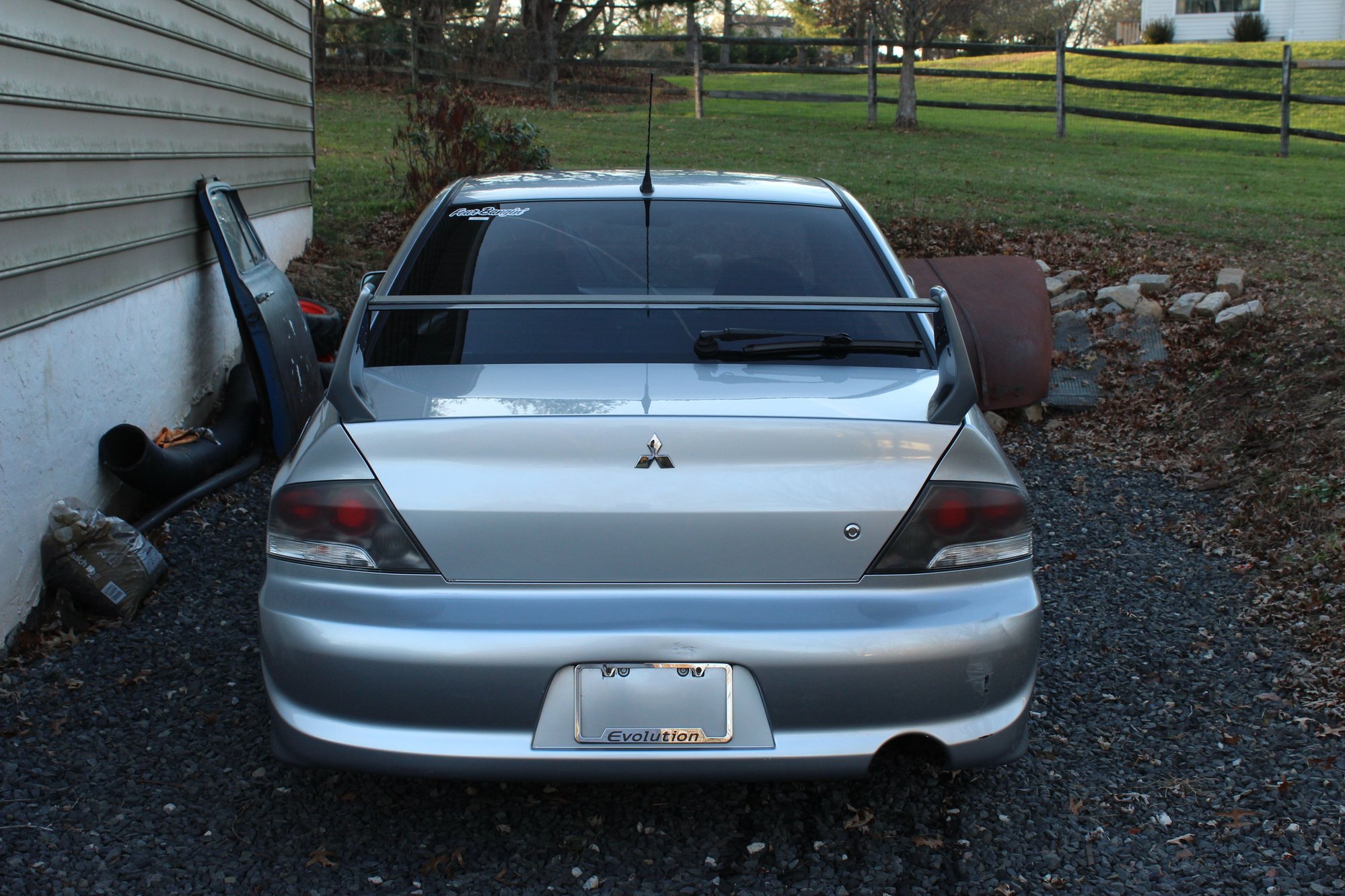

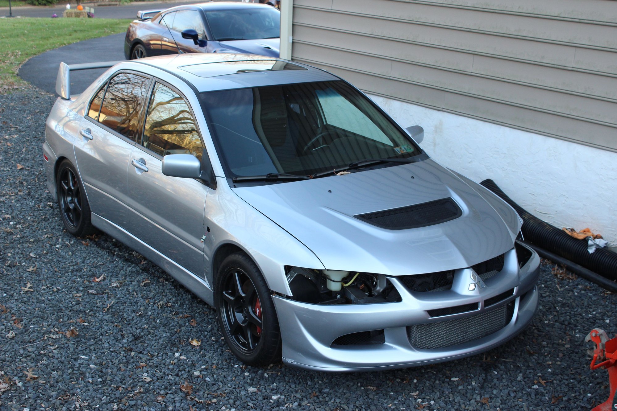

Previously i picked up an evo 8 with a blown motor. Built for 600+hp and only 37k on the dash. Bought it for $7500 (yes, 7500 bucks for a 600hp evo) and it needed bearings because they were spun. Best of my luck, i need new pistons and a crank upon further investigation. Just got a recap today and the new pistons and crank are in and the engine will be ready just in a few days. Here's some pics of the car but the bumper is just hanging on right now and the headlights are off. I'm new to the evo community and to driving so feel free to leave some tips and etc. below. Thanks!!
