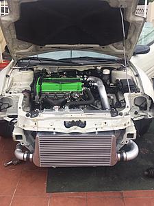

I have a 2005 eclipse with a 4g64 block and 4g63 head fully built. i went to dyno today and the car is knocking even if you dry rev it, the tuner would take out timing for it to make any type of power. They are telling me its due to my high compression 10.1.
I do want to add that even before the car was built and the evo head was added that i still had knocking issues with my car. A completely different tuner tuned the car when it was just on boost and it had knock issues.
Any suggestion or advise from the tuning gurus/mechanics would be appreciated, below is a mod list of the car
BLOCK :4G64
bored 0.20 over
manley turbo tuff rods
acl race bearings
arp 2000 rod bolts
h11 head studs
wiseco 10..5 compression pistons
balance shaft deleted
oem water pump
oem timing components
balanced crank
HEAD :4G63(EVO)
super tech dual springs and retainers
super tech valve seals
super tech valves
kelford 272 cams
skunk 2 cam gears
oem valve guides
oem valve locks
TURBO SETUP :
garret GT35R
cast iron exhaust manifold
tial 38mm wastegate
tail blowoff
4.5" intercooler
custom 3" downpipe
custom 3" exhaust
ELECTRONICS :
aem wideband
aem serial guage
aem ems v1
greddy turbo timer
FUEL SETUP :
12 gallon fuel cell
twin bosch 044
-10 feed
-6 return
fuel lab fuel regulator
bosch 2200cc injectors
Billet design fuel rail

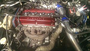

I have a similiar setup 9.8:1 your mechanical timing is wrong. Heres mine
