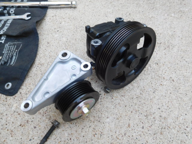

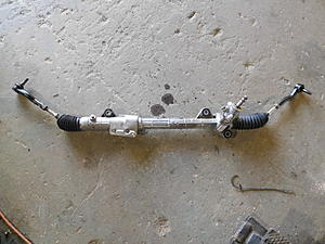

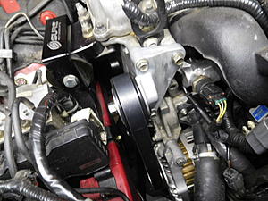

Not sure about Evos, but a couple months ago I switched to manual steering on my Mazdaspeed6. I do road race the car and the very first day at the track was a *****. Then, something switched inside my head and the second weekend I managed to get within 2 seconds of my best time with power steering.
If you guys have adjustable caster, you will probably want to run as little as 3 to 3.5 degrees. I run 255 tires at the track and at some point want to switch to 275 but first need less caster, it is in the works (I am at about 4 degrees now).
I had the steering rack depowered Flyin' Miata style (google up instructions) and initially used a gutted stock p/s pump as an idler pulley, just shaft and bearing left inside and pump filled with engine oil. Then I realized a second gen Mazdaspeed3 switched to electric steering and I was able to use their idler on my speed6.
If you have an aftermarket steering wheel, make sure to LocTite the bolts, I had so much vibration through the steering column that it loosened all the bolts, clip below.
https://vimeo.com/156986420
Attached Thumbnails Power steering delete?-dscn1920.jpg   Power steering delete?-dscn1926.jpg   Power steering delete?-dscn1927.jpg   Power steering delete?-dscn2196.jpg   Power steering delete?-dscn2205.jpg
