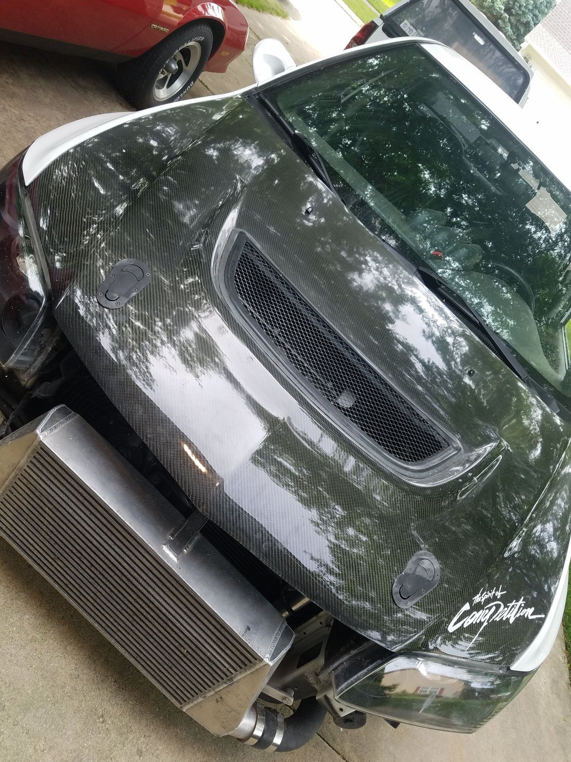

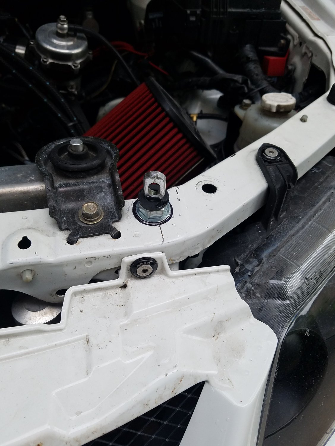

I drilled my holes for the actual pins too big and they don't stay basically the washers come up through the holes. The latest jes themselves are installed perfectly. Not sure what I can do now.

To clean that up:
Lightly roughen up w/a Scotch Brite pad & tape off. Spray paint to match
Get a set of stainless washers to make that hole smaller & mount the pin. Trim the washer on one side if needed to make it fit.
No big deal, you can clean that up & make it work.

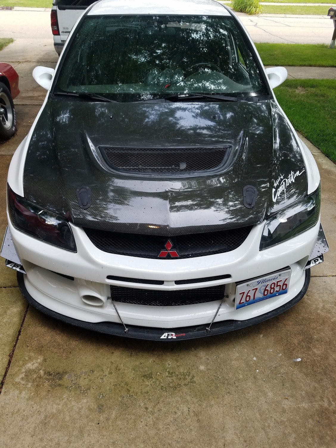

Worked perfect I bought new pins and washers

Thats it!
Nice job!
