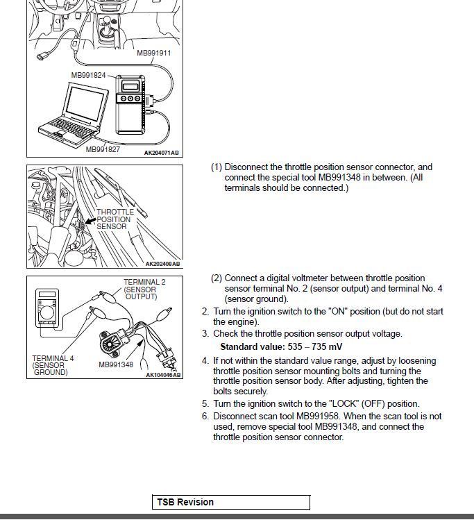

Hi Ferp
Read this thread here that discusses TPS issues /EVO scan & the percentages that are normal & out of range
Also, heres a portion of manual that shows how to test the TPS sensor using a voltmeter
https://www.evolutionm.net/forums/ev...djustment.html

the dvom will help but to better diagnose a tps you need to graph it and perform a snap throttle test. the sample rate of a dvom is slow.
