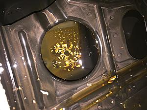

I had the exact same symptoms. Did all the same things to try and fix it. Gsc lifters. Different oils. Comp test. Couldn't find anything just a ugly tick that seamed to come from from back of valvecover near cylinder 1. Just learned to ignore it. Till I went to a track day at California speedway. And the 2nd lap of the last session I herd a terrible knock. Pulled off track. Car idled fine didn't sound any different till after 3,000rpm and it would make a horrific knocking sound with vibration. Towed it home and pulled the pan to find this.

^it may be worth pulling the pan off just to check for something similar. Obviously, we all hope it won't be something that serious but may save yourself some time if thats the case.

Like I said I shined it on because the care was still running like a champ. I was killing it on the track. At first I thought the noise was the porche I was passing then I felt the vibration. And my focuse became the noise and my hart sank to the floor and I knew because I have herd that sound a hundred times before, it was game over.

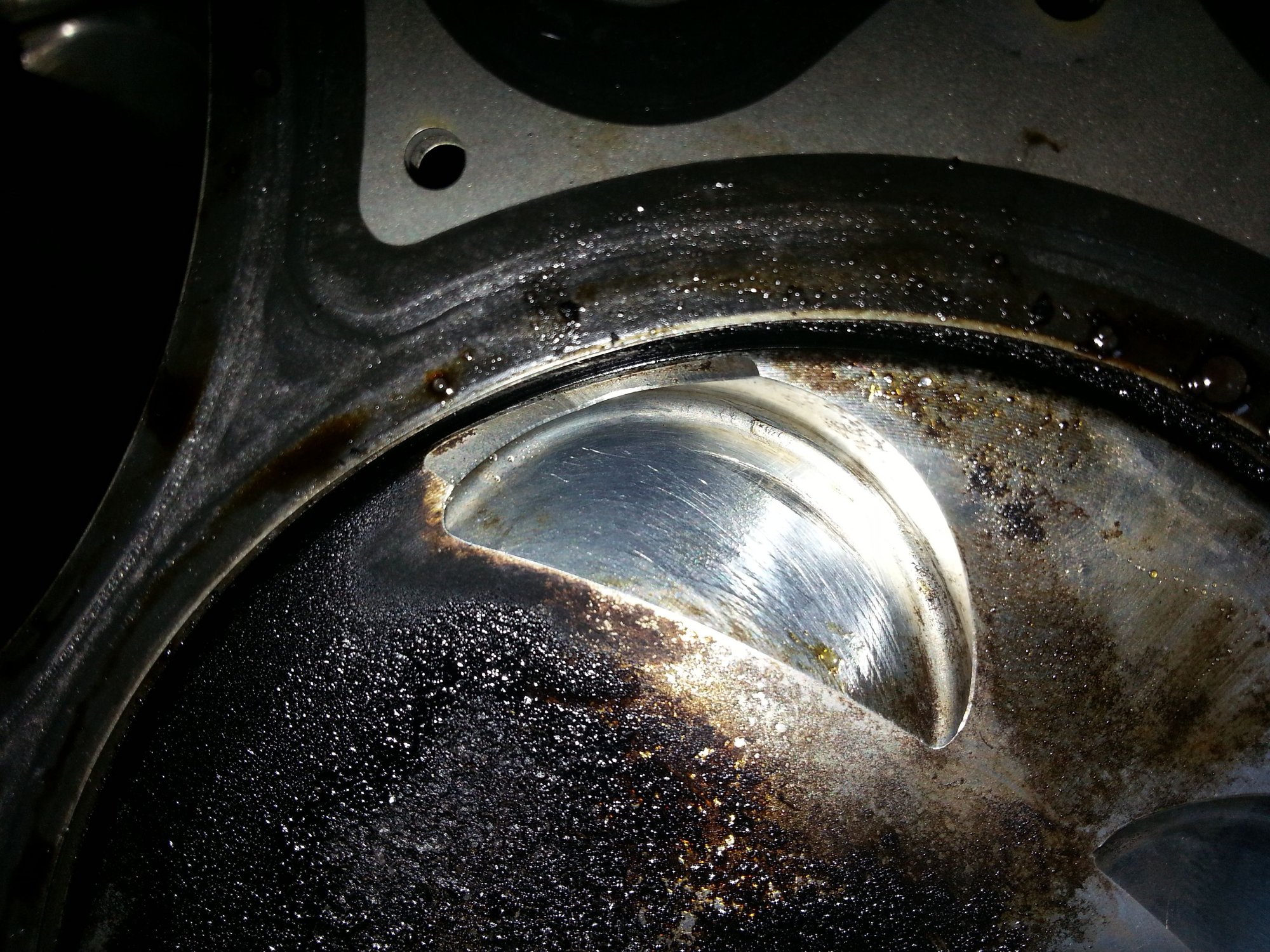

ok i found where was coming the ticking noise, slightly piston to valve contact in cylinder 4 intake side, i think i could have avoided this if i'd have used an evo 9 HG instead of an evo 8 one. anyway i'm going to check if valves are bent.

From: IOWA
What pistons are those? glad you found the issue.

From: miami
its a buschur 2.0l shortblock i believe they use JE pistons

Originally Posted by nadevo
ok i found where was coming the ticking noise, slightly piston to valve contact in cylinder 4 intake side, i think i could have avoided this if i'd have used an evo 9 hg instead of an evo 8 one. Anyway i'm going to check if valves are bent.
how did this happen ?
Old Aug 3, 2016 | 07:00 PM
nadevo's Avatar
Joined: May 2011
Posts: 44
From: miami
honestly i dont know, true is that i didnt check clearance when put the engine together. Btw valves seem to be ok.
