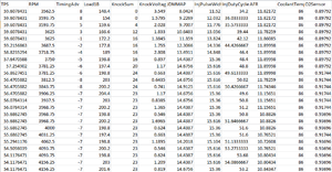

hi, guys
I really need your help before start disassembling my engine.
long history short, the first time i started the motor it was making a ticking noise, i tought, it was lifter noise, after checked everything else was good to go i scheduled my tune appointment, in my first pull i saw 36 knock counts!! obviously we couldn't continue so since then i'm trying to find out whats happening with my car!
things i already checked and changed:
1) bleed oem lifters
2) installed gsc lifters
3) replaced injectors
4) exhaust leak
5) changed oil from 20w 50 to 10w 30
6) checked valve springs, rocker arms,caps and cams countless times
7) replaced knock sensor and checked torque spec
8) installed stock cams
9) checked timing marks and timing belt tensioner
10) cut oil filter found nothing
11) compression test is 189psi all 4
none of these solved my issue!
the ticking noise gets louder and faster with rpm increase so knock sensor is picking it and showing high count.
what do you think guys? I really appreciate any help you can provide
mods are:
Buschur 2.0L (300miles aprox without boost)
Curt Brown head with supertech springs
s2 cams
stock turbo
stock injectors
balance shaft deleted
exedy triple
etc etc

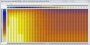

here's a video,log and timing map
Attached Thumbnails ticking noise + high knock count-log.png   ticking noise + high knock count-timing-map.png

You should remedy the tick. It's clearly causing all that knock, and if you desensitize the knock sensor in the ROM so that it ignores the tick it won't pick up real knock.

yes i also think the tick is causing all the knock, i increased the knock multipliers and did nothing the knock count still there. Before i installed the gsc lifters i cleaned and bleed the oem lifters
