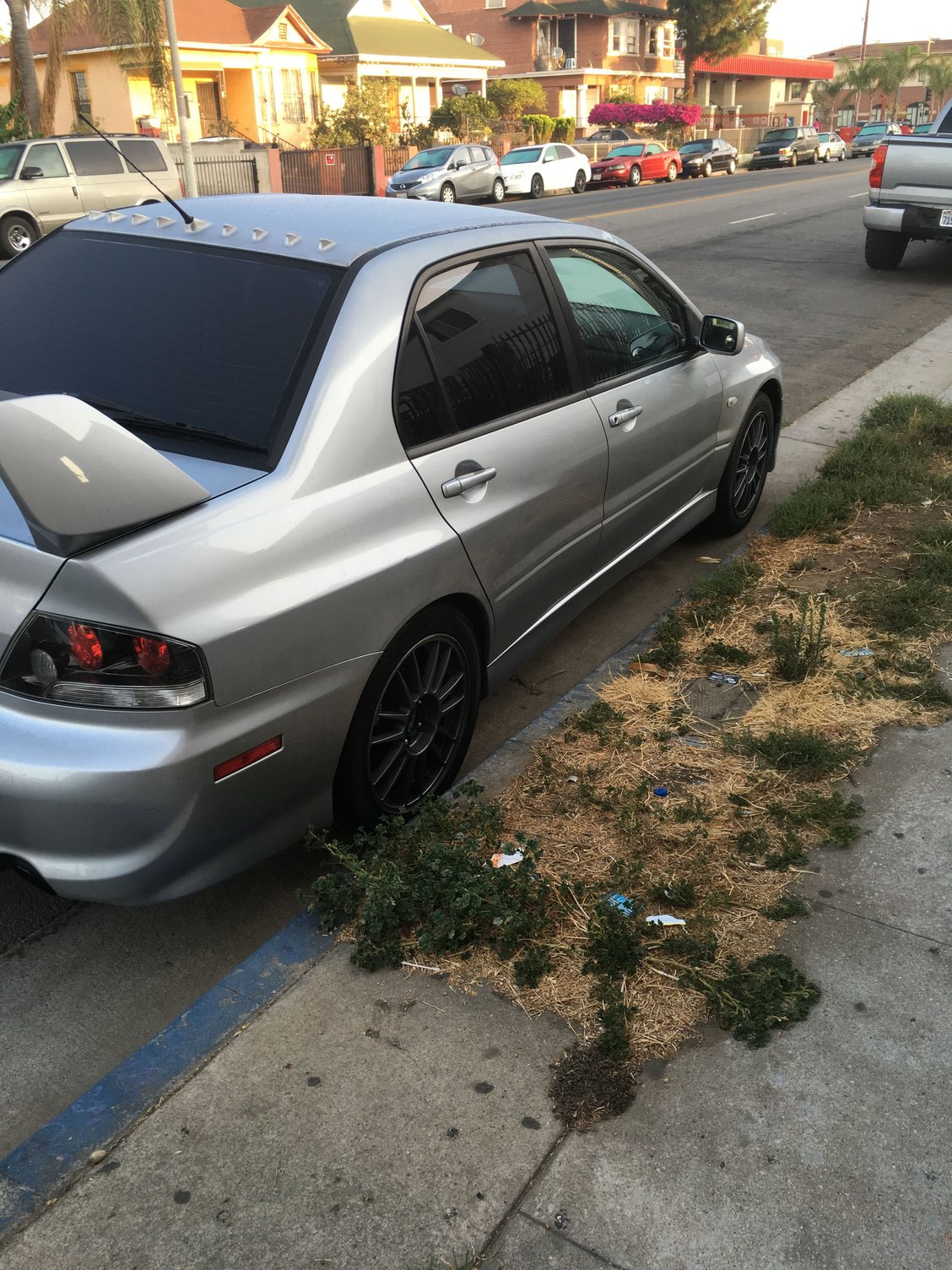

My Evo MR
Old Aug 20, 2016 | 01:45 PM
Evo_Goodness's Avatar
Joined: Jun 2016
Posts: 311
Likes: 14
From: oregon
Looks good I would get the really vortex generator myself it the exact same color as mine hmm now that I think of it is apex silver the most common evo color lol

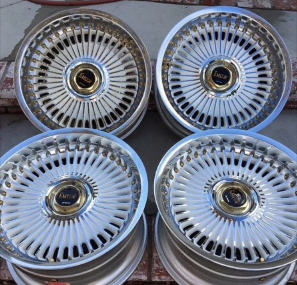

Thanks man and I also have these wheels for it 18x10+32 work emitz
