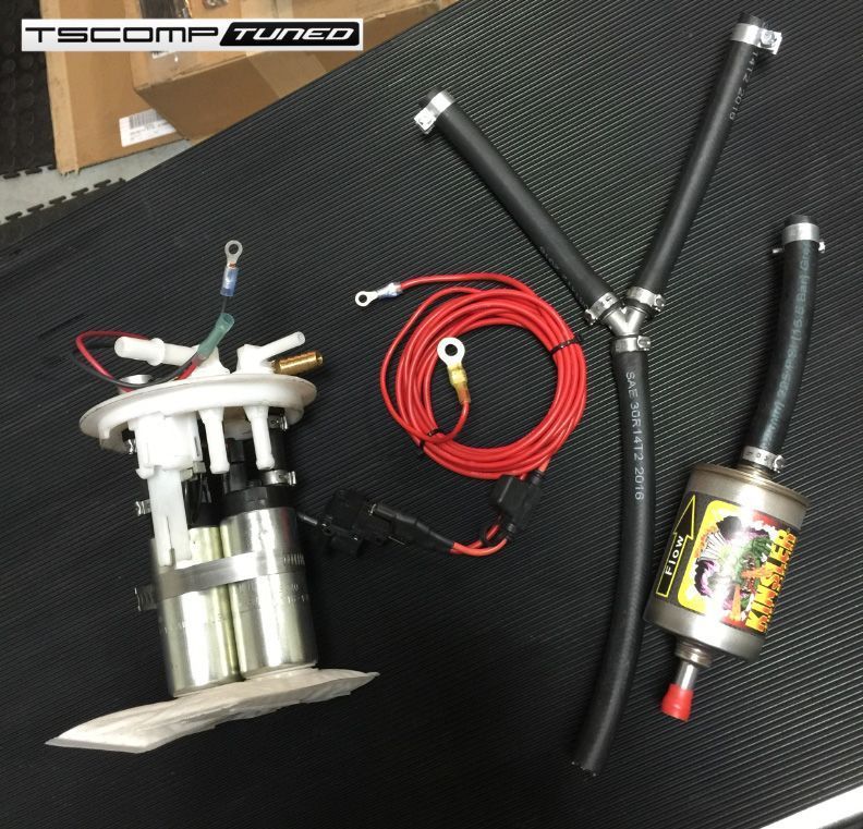

Sounds like, for sure, you are out of pump. I would consider using this pump kit which looks nicely set-up here:
The vendors notes here:
If anyone's interested, its $500 with your core, or $600 without your core.
http://www.tscomptuned.net/fuel-system.html
