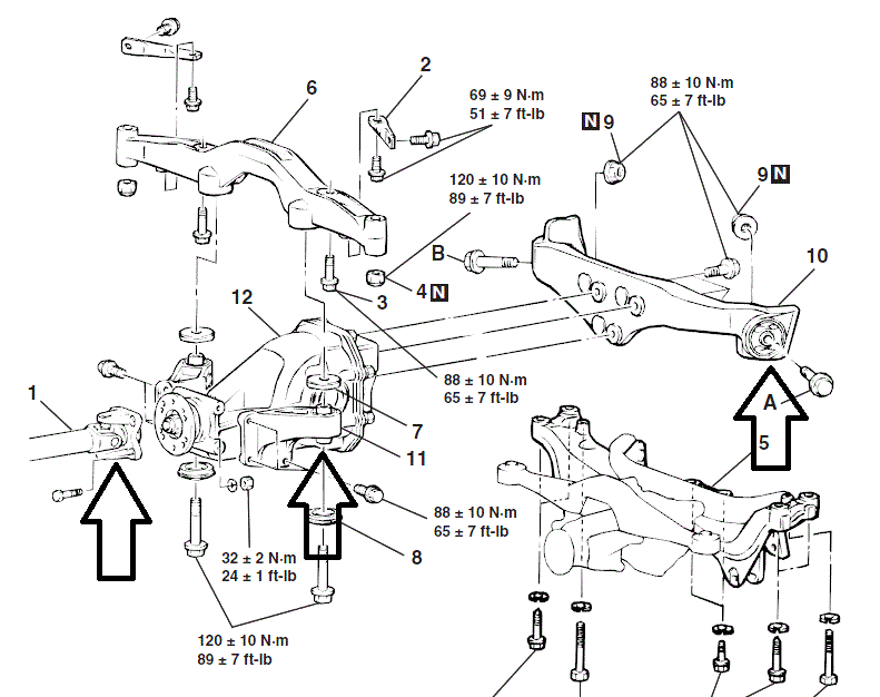

Time to put this on a lift or a set of ramps & check the rear diff bushings. Possible rear diff clunk going on
Check the driveline mounts & the u-joints as well
