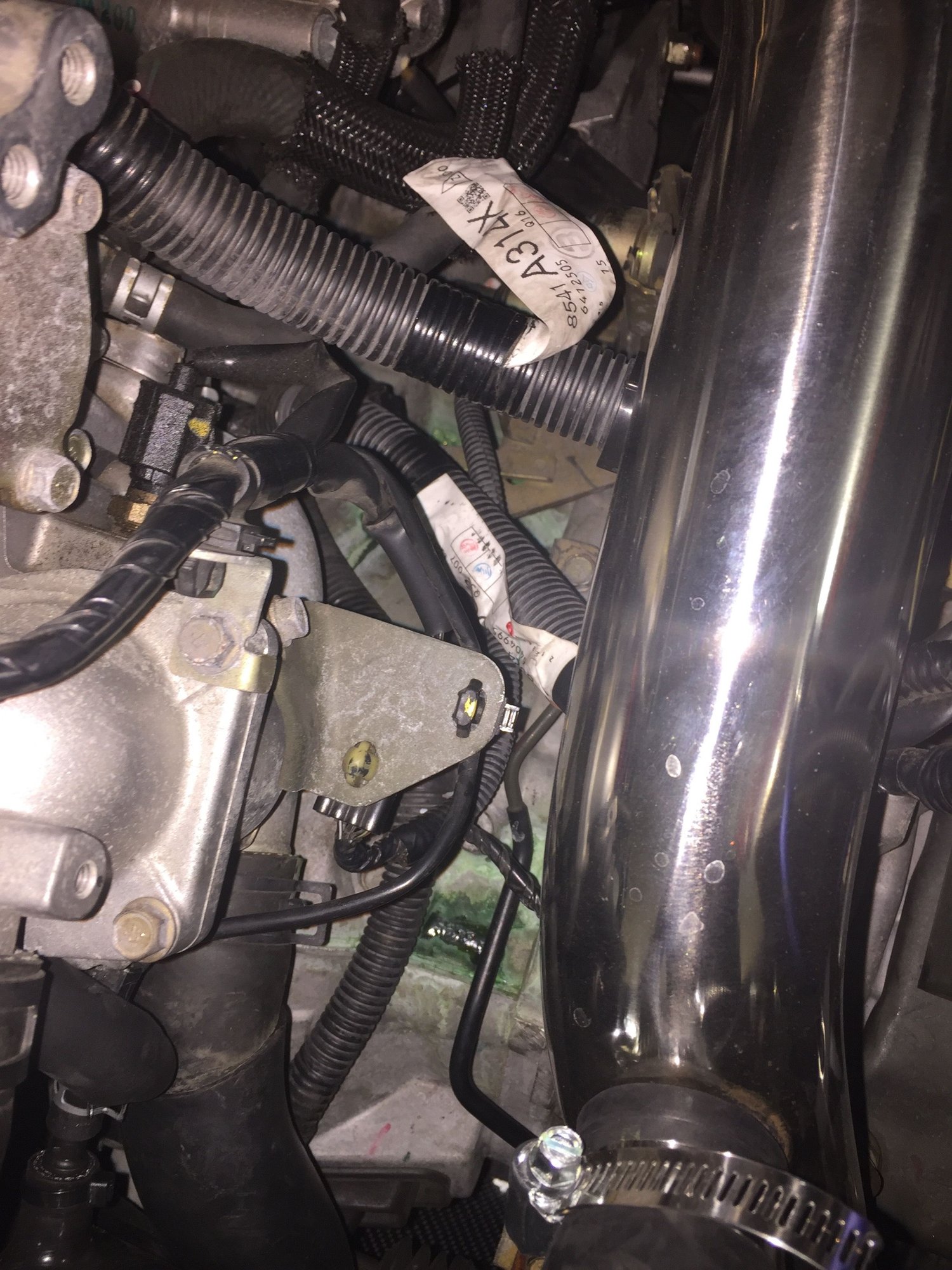

So I have apparently developed a coolant leak for unknown reasons. I'm not sure where it is coming from? I've inspected the surrounding hoses as best as I could and don't see anywhere it would be leaking from.
any suggestions?
Heres a picture. evo 9. 52k miles

Radiator pressure tester.

Very common for the coolant lines going into throttle body leak. Probably small leak and misting everywhere
