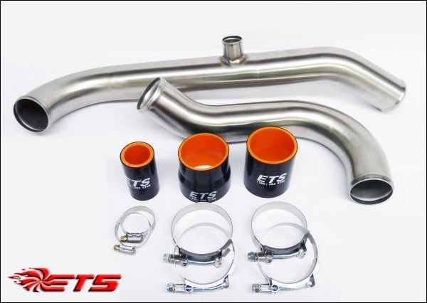

I am running a speed density intake(with brass nipple) and I need guidance to what to buy. Im looking at "ETS Mitsubishi Evo 8 and Evolution 9 Upper Intercooler Pipe”
link is here(http://www.extremeturbosystems.com/E...oler-Pipe.html)
or
I’m wondering if i need to purchase a BOV thats Vent to Atmosphere or etc.. The pipe on the top in the picture, is that where i hook up the bare Blow Off Valve(like the HKS sequential with BOV sitting on top of the Pipe coming from Intake Man.) or is there something else to it? thanks!

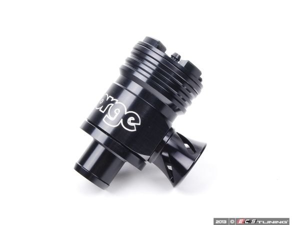

possible BOV
https://www.ecstuning.com/b-forge-pa...FYIkgQodkjAOlA
OR

you can run VTA or recirc, doesn't matter
you'll want to buy/decide on the BOV first then buy the UICP beacuse you want the flange to match. the flange in the picture you posted is for a tube. they sell tial flanged UICP, synapse, etc etc

If you are going to go VTA, then call ETS and have them weld a TIAL flange to the piping when ordering and get a TIAL BOV from them while you are at it...
