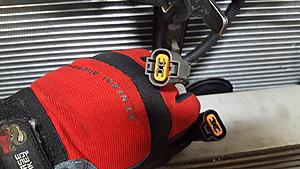

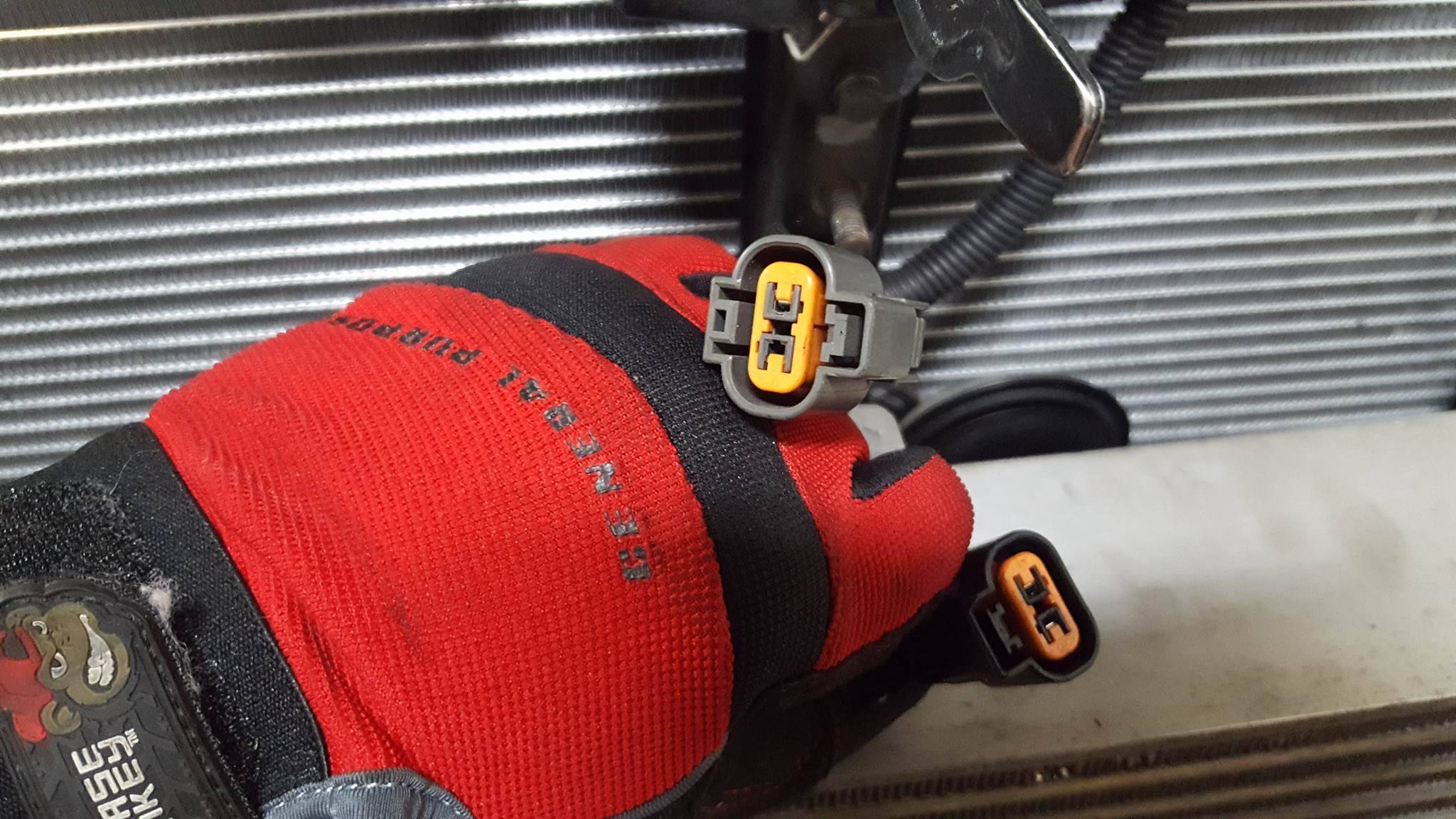

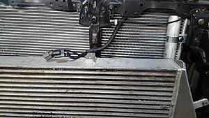

So I was messing around with my front bumper cover off and found these two plugs coming off the horn harness. There is nothing here to get plugged in, and since I wasn't the one that took the car apart(a shop did it and they lost a TON of parts before I recovered it). I cannot figure out what went here. The car runs fine as I have been driving it for the past week. Any help would be appreciated. Thanks!

It appears youre missing the electric fan that mounts to the passenger side of the A/C core (item 87049)

Well that makes sense. Thank you
