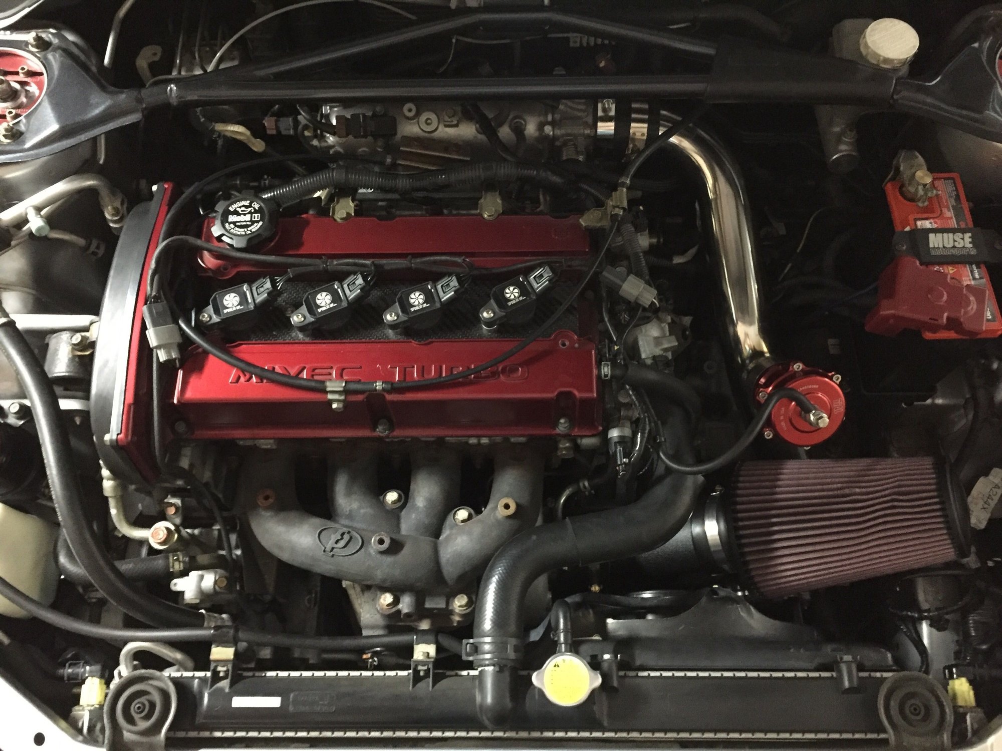

I'm trying to get my new Tial Q to stop fluttering so much. If I just barely get into boost and let off, it flutters - then blows off. At idle my car pulls 12-15 inHG. Which is rated at the 8psi spring. I bought it to replace my 10psi spring which was fluttering.
What else can I check?

Did you let the car warm up before you took your readings in vac? The 8 lb spring is the correct one according to tial. Where do you have your vac pulling from on the bov? Should be intake mani. Do you have an external wastegate? Could be hearing that fluttering instead of the bov.

Yes I let it warm up. Vacuum source is coming from Intake mani like from the factory. Internal wastegate (turbosmart actuator)

Get rid of the factory hard line and run a dedicated 1/4" ID hose straight from the bov to the IM and see if that modulates the issue at all.

Do this for sure. Tial wants a dedicated 1/4 lines for it's BOV, the factory hard line is not 1/4" ID.
