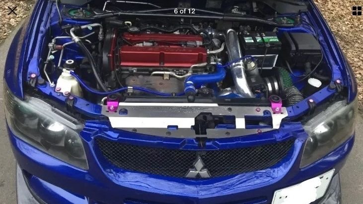

Spec of the car:
Tein superstreet coil overs
Hks ssqv blow off
Hks hardpipe system
Custom 3” straight through pip with 4 ½ tip
Ebc discs and pads
Cambelt and balance shaft changed at 65 (currently on 70ish)
Excedy racing clutch
Hks big intercooler and pipework
Hks induction kit
Mechanically engine is mint got it inspected 3 times.
Last dyno 418bhp@6850rpm and 376.8ftlbs@4950rpm (haven’t done myself yet due to issues)

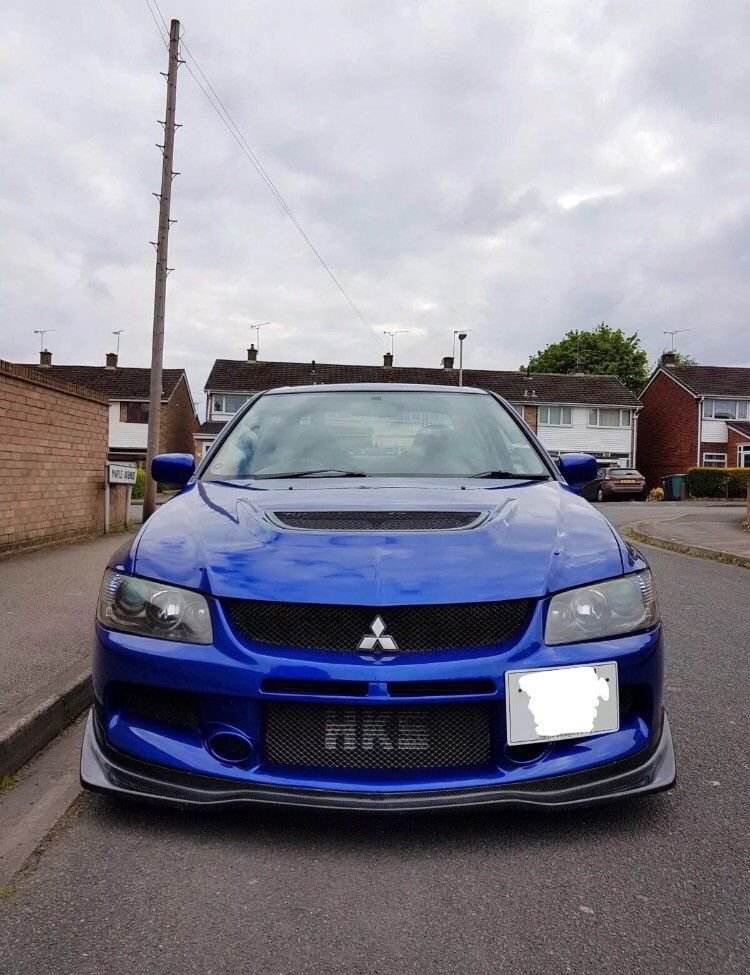

Welcome! Car looks great!

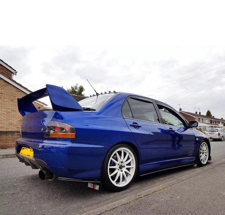

Congrats on your purchase! Electric blue is starting to grow on me. If I get another Evo that's probably the color I look for

I remember reading where somebody did a search on the selling price of used cars based on paint color and found blue fetched the highest price.
