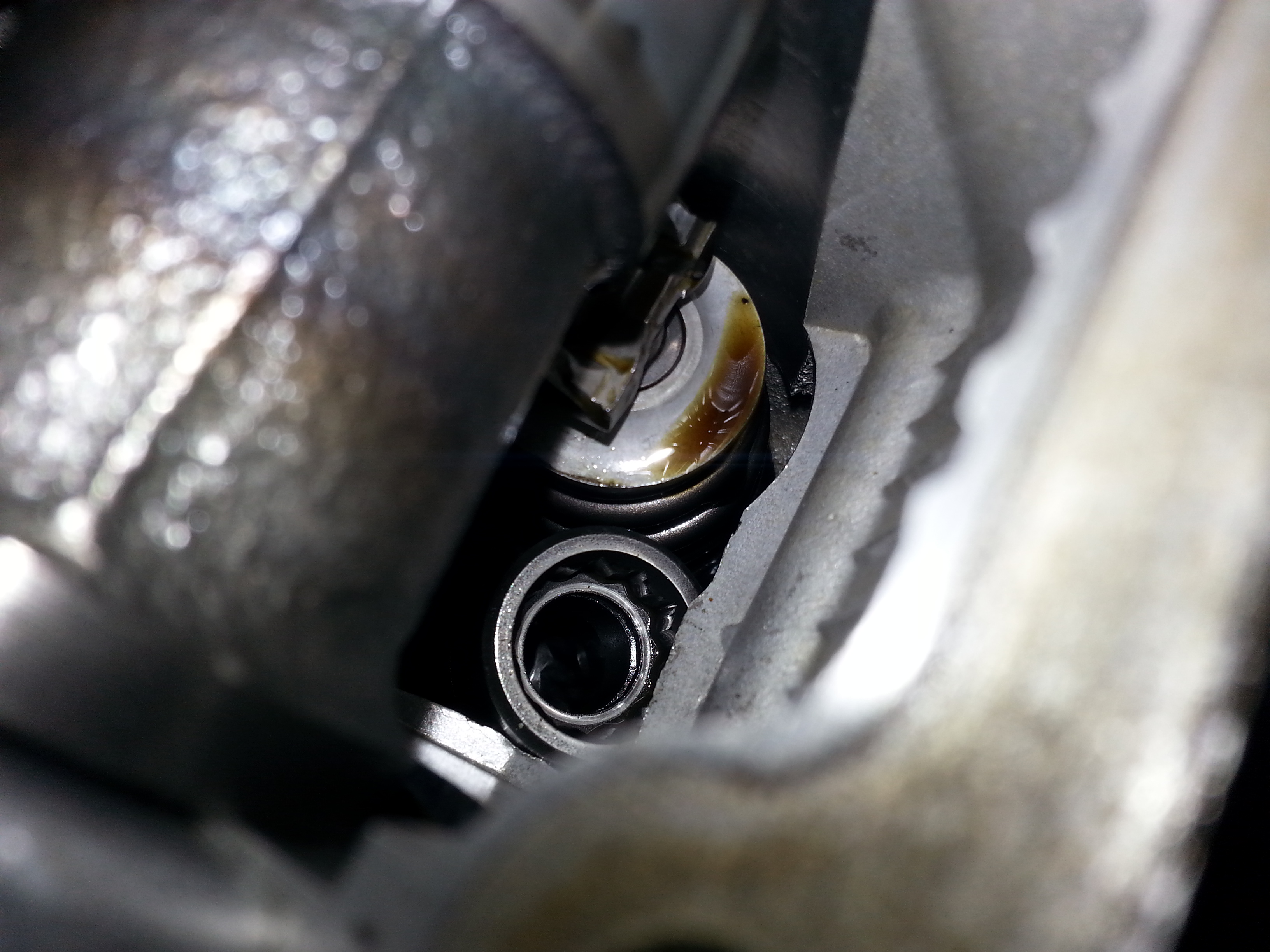

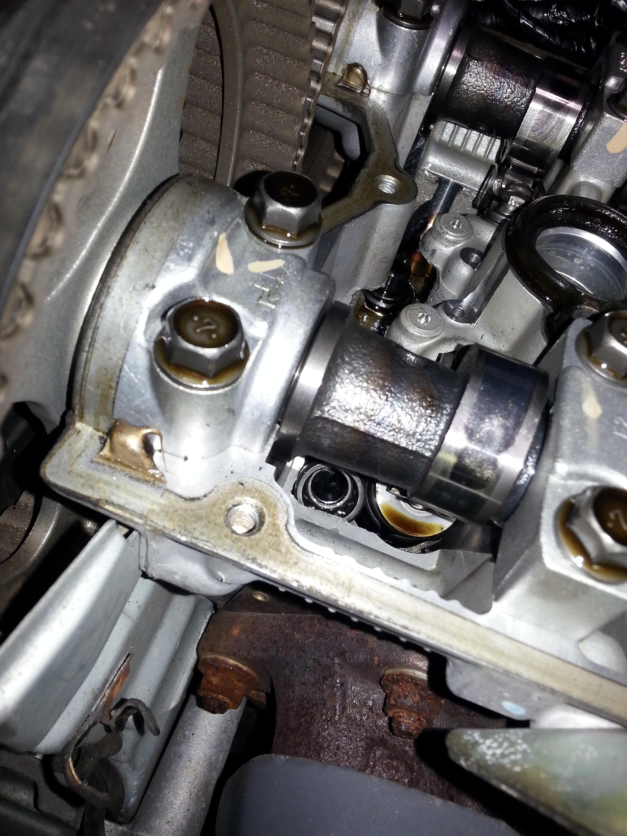

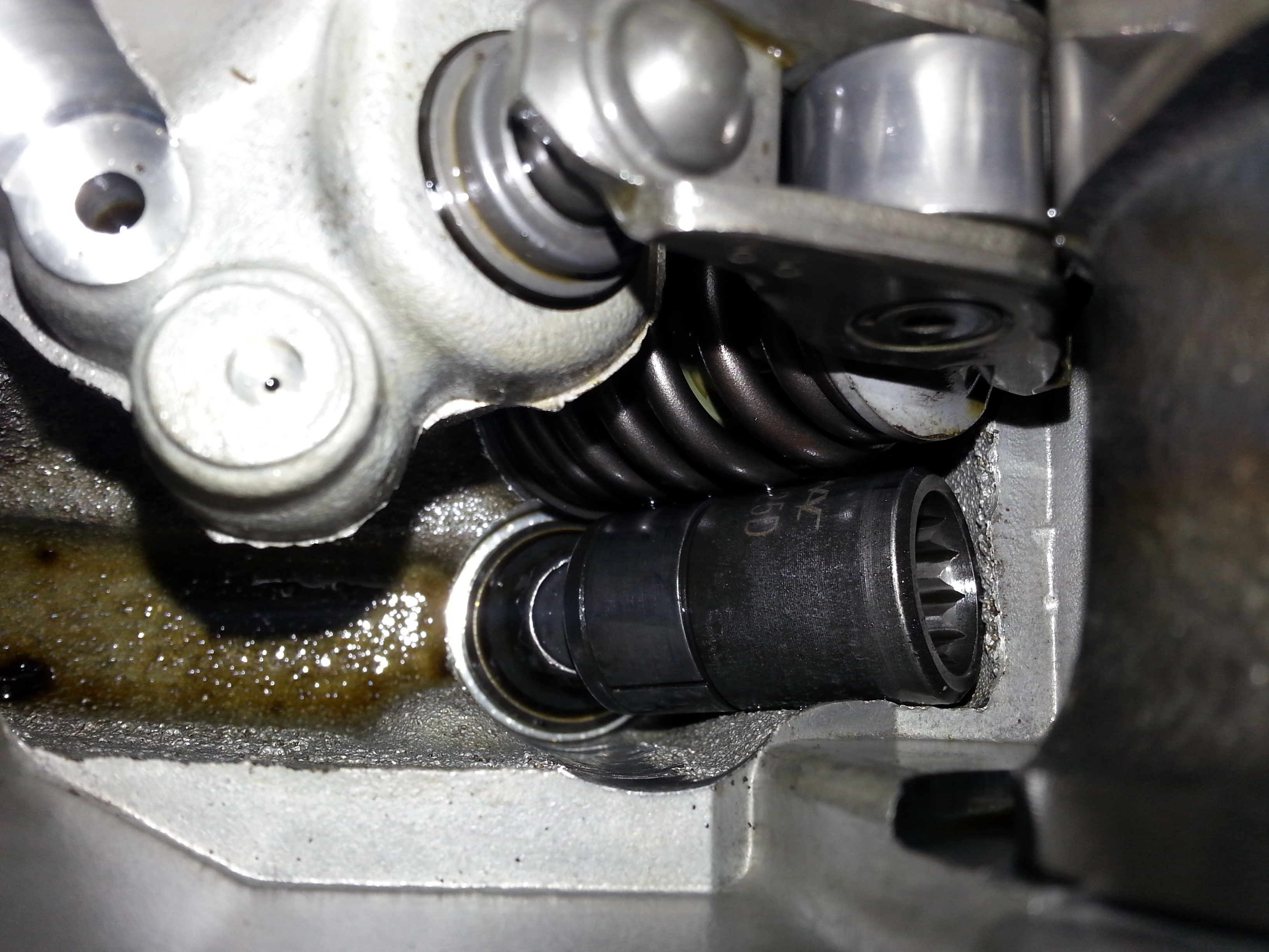

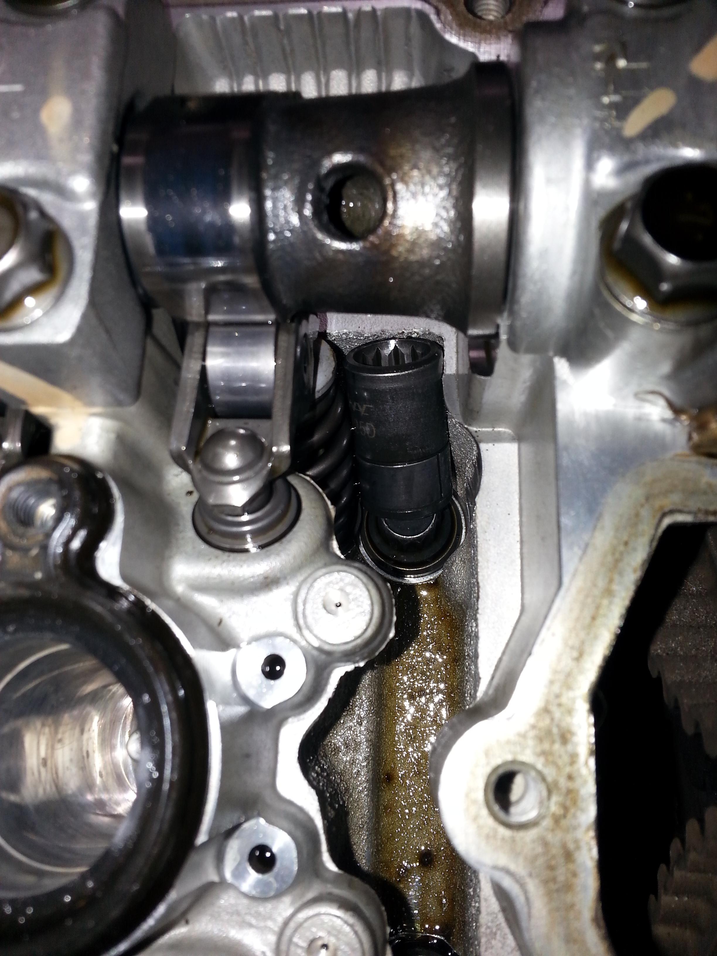

Mitsubishi left a socket in my engine from the assembly line-i4rymug.jpg Mitsubishi left a socket in my engine from the assembly line-wroucet.jpg Mitsubishi left a socket in my engine from the assembly line-nkzxfhu.jpg Mitsubishi left a socket in my engine from the assembly line-hei2dyf.jpg Mitsubishi left a socket in my engine from the assembly line-l8pmu7b.jpg Mitsubishi left a socket in my engine from the assembly line-l9lbx1o.jpg Mitsubishi left a socket in my engine from the assembly line-nzngslh.jpg Mitsubishi left a socket in my engine from the assembly line-zungr6p.jpg Mitsubishi left a socket in my engine from the assembly line-cjwxoqx.jpg Mitsubishi left a socket in my engine from the assembly line-btoffa8.jpg Mitsubishi left a socket in my engine from the assembly line-0dm3zoh.jpg Mitsubishi left a socket in my engine from the assembly line-cqnfnhj.jpg
Old Aug 9, 2017 | 12:46 PM
Wow, what a find
What prompted you to pull the valve cover? (noise?) & are you sure no head / cam work was done to this EvO?
That could have or did it do any damage?

The engine was making some lifter tick noises under cold-start, so I figured the lifters needed bleeding/replacing

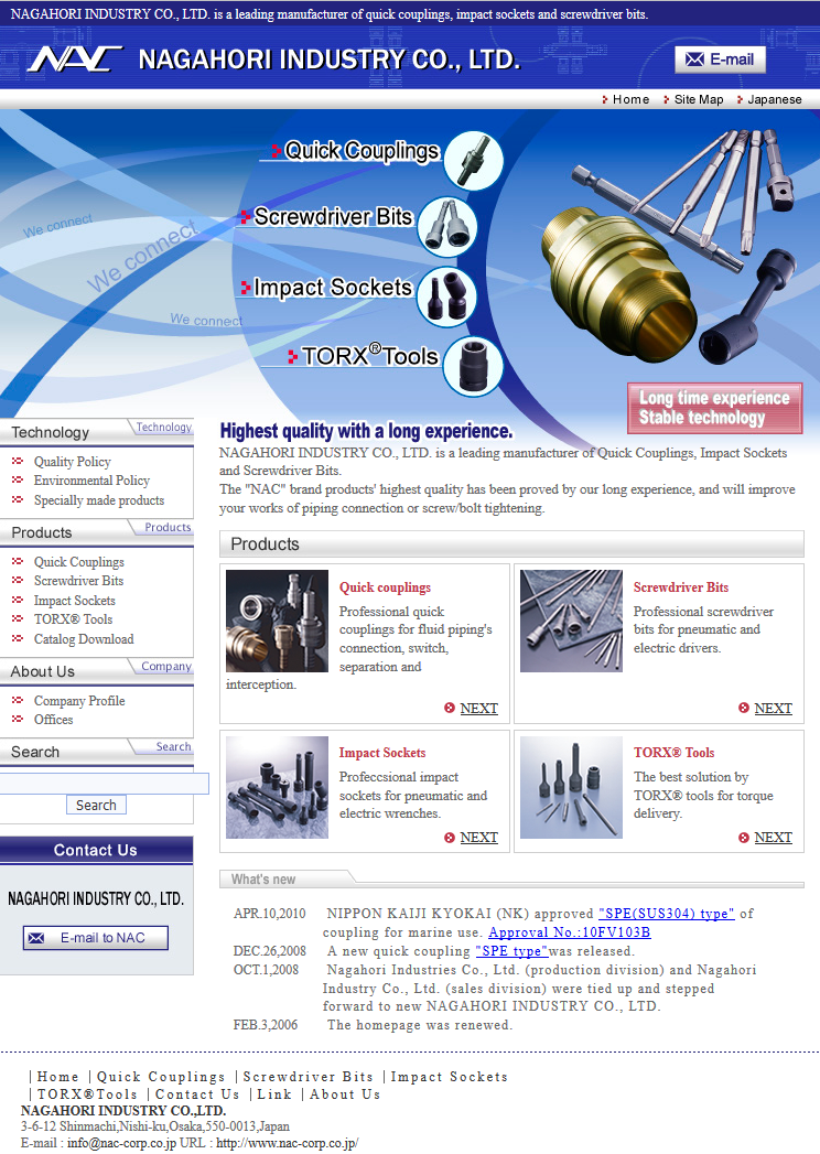

Looking at the markings it belongs to a Nagahori Heavy Industries

That valve spring and retainer should be replaced, and check the valve guide for excess wear. Pretty ****ty mitsu isn't willing to do anything when it's clearly 100% their problem. That's not even a "warranty" issue. I would take that higher up the food chain.
