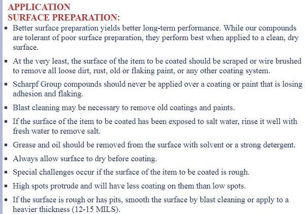

This evo is my daily driver and just want to make sure it's safe to drive lol. Yea, I have undercoat, but haven't had the time to do it yet.. Do you use a wire brush, sand it, then spray the undercoat?

Heres the product we use & the recommended prep:
