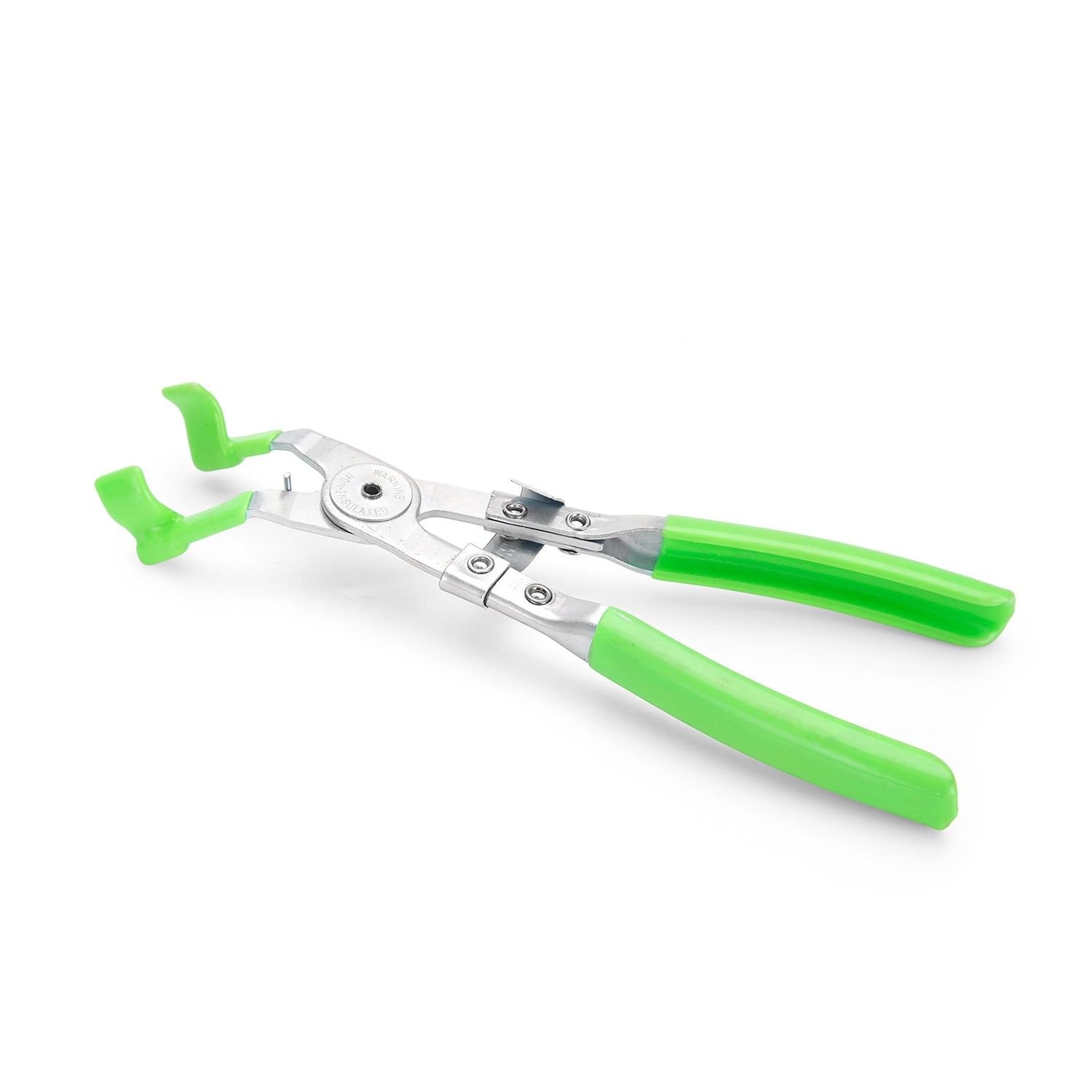

You can use plyers and put a shop rag over wire so you dont tear it. Turn and pull up. Not from the wire but from boot. This is the correct tool to use but you can get creative.
