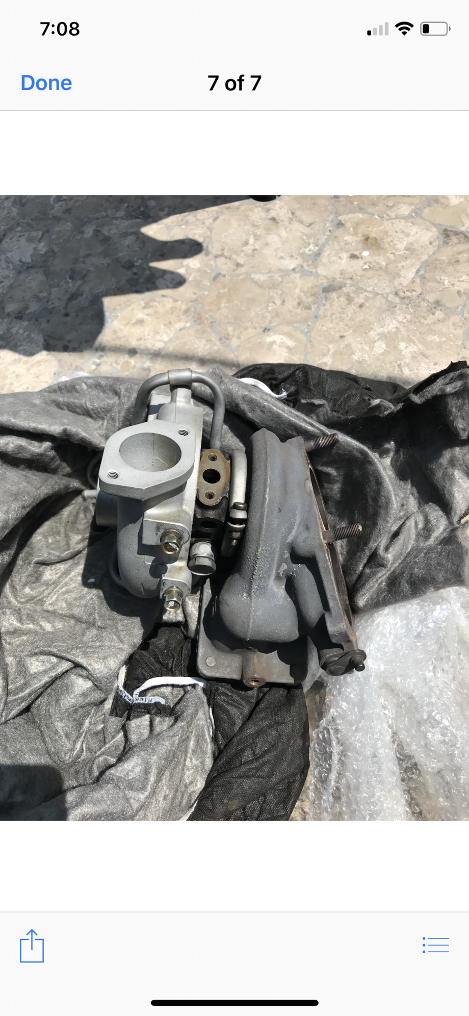

Hey guys, got my 2005 Evo about a month ago and have been buying a few parts since then. I’m aiming for about 450-475 that’ll keep toque below 400. I came to this used Old School FP Green turbo for sale. It has been freshly rebuilt and ported by Abby from milspec according to the seller. I’ll post a few pictures below to see your opinion. Thanks !

You'll need to run E85 to make 450 on that turbo. And it will need a good combo to do it. Cams, O2 dump, 3" exhaust, intake, etc.
I have all that but the turbo. Haven’t mounted nothing on. I also have ported out both the stock instake and turbo manifold.

$799 I have a green on my evo 9 and love it but if I was buying one now.....
http://www.forcedperformance.net/mer...e=Lancer-Turbo
