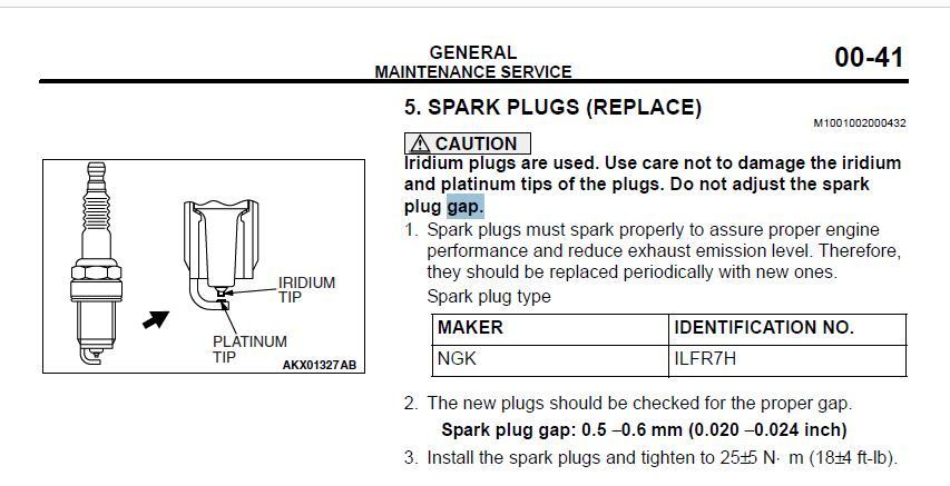

Okay so im on 20 psi, how much do i gap my spark plugs ?
Old Mar 3, 2019 | 07:24 PM
Not sure what EvO you have but heres the 9 spec
Old Mar 3, 2019 | 07:27 PM
Evoguy!123's Avatar
Joined: Mar 2016
Posts: 98
From: Pasco WA
got an evo 8, getting these damn fuel cuts that iv never had before. Also like in 3k rpms sounds like it bogs out
Old Mar 3, 2019 | 07:50 PM
Wicked_X's Avatar
Joined: Feb 2018
Posts: 154
From: Sacramento, California
If I were you, I would invest in some datalogging tools so you can know what is actually going on. Do you have a wideband o2 installed?
Evoscan and a tactrix cable are your friend.
Just gap it down to like .022 and see if issue is still present, then reassess.
