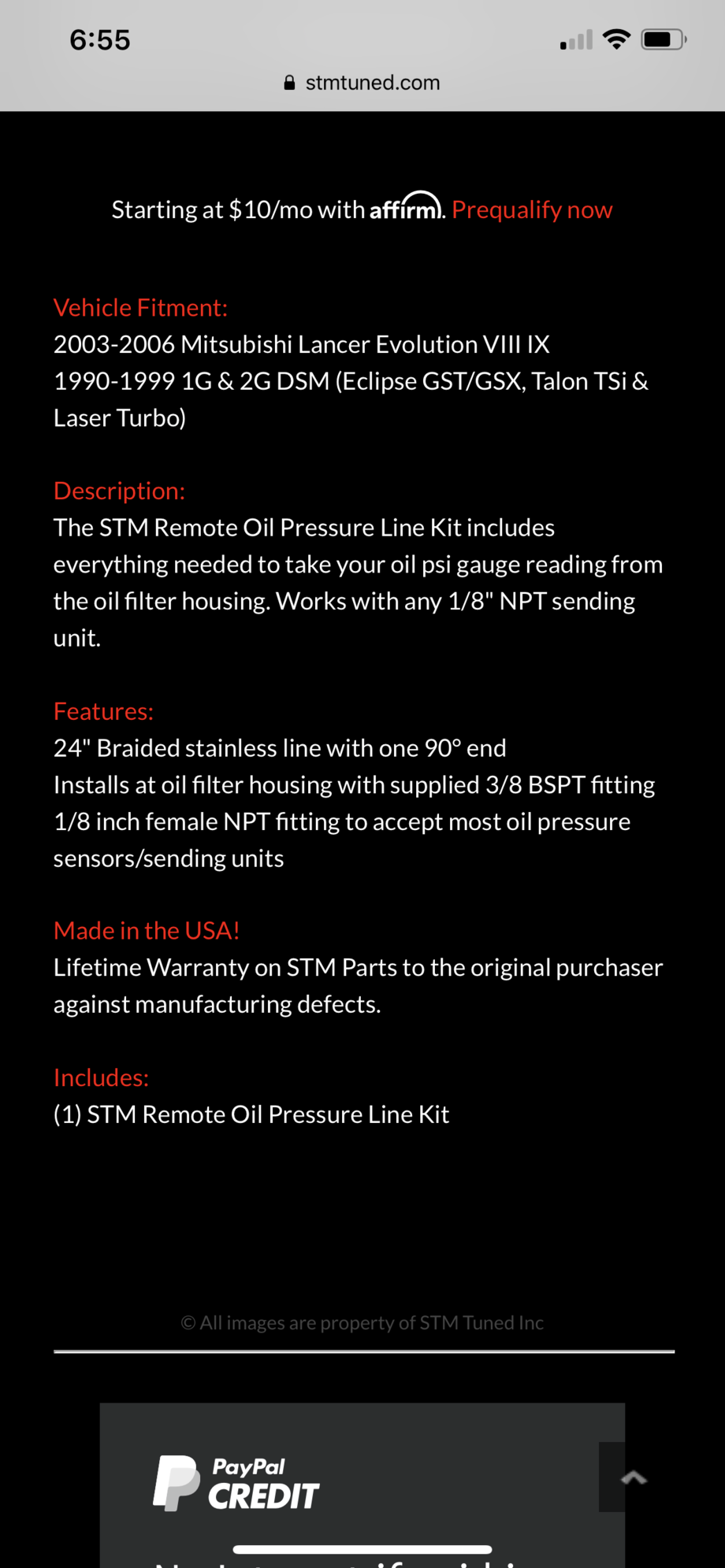

According to the site. One End is 1/8 NPT and the oil filter housing side is 3/8 BSPT.
Seems like the guys with the STM line are good to go. Still use sealant though.

STM did mentioned that their remote line has a 3/8 BSPT thread. I'm gonna go with STM line. It's only 15 bucks more than AMS.

Lol sorry I guess I can see how my comment was confusing. Let me try again...I have no idea what size fitting AMS has for their line. If they say its NPT then I would believe that it is NPT. That being said National Pipe Thread is the incorrect threads for our OFH and the correct size is instead 3/8 BSPT. Pal expanded on what I was getting at and this is the reason why this has been debated in the past because people have the false sense of reality thinking that it is NPT since it will thread in and when you goop it up and soft AL threads or brass threads for a fitting ends up potentially sealing.
However its still not NPT so get the right fitting. Personally I purchased the STM remote sending unit line which included the proper fitting and hey guess what, it doesn't leak!
