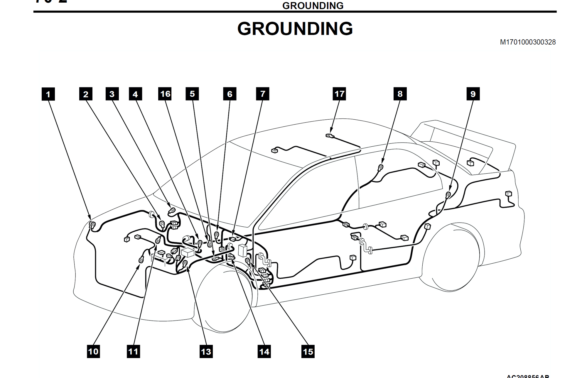

Since it happened the second time when you hit a pothole and the only code you have gotten is for the speed sensor then maybe electrical. I suggest you start at the speed sensor and work you way back on the wiring checking for loose fitting or corroded electrical plugs.

Agree with barney sounds electrical,check wiring and grounds. maybe pull some the grounds and clean them up since you say your car sits. Keep us updated good luck

check all your grounds
