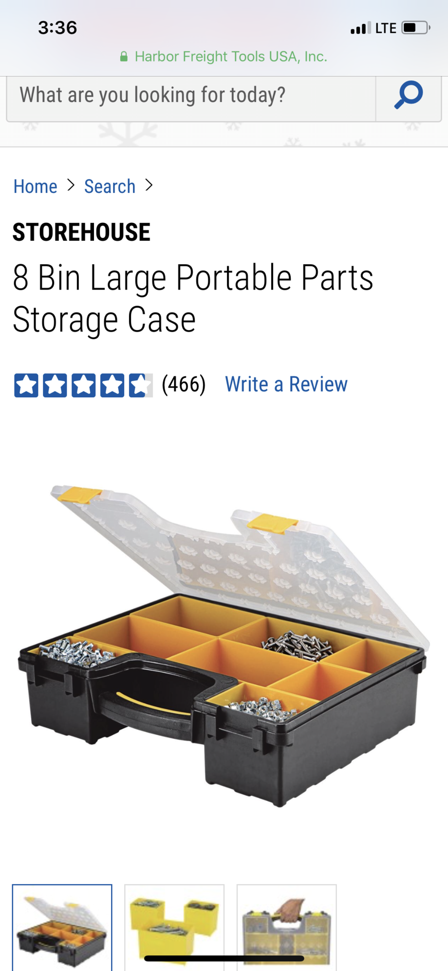

frsh92laser's Avatar
Joined: Oct 2010
Posts: 87
Likes: 21
From: siny
bag and tag is easiest without leaving the house but if you have a harbor frieght in your area i like using these style organizers. they have a few different styles with different size bins.
