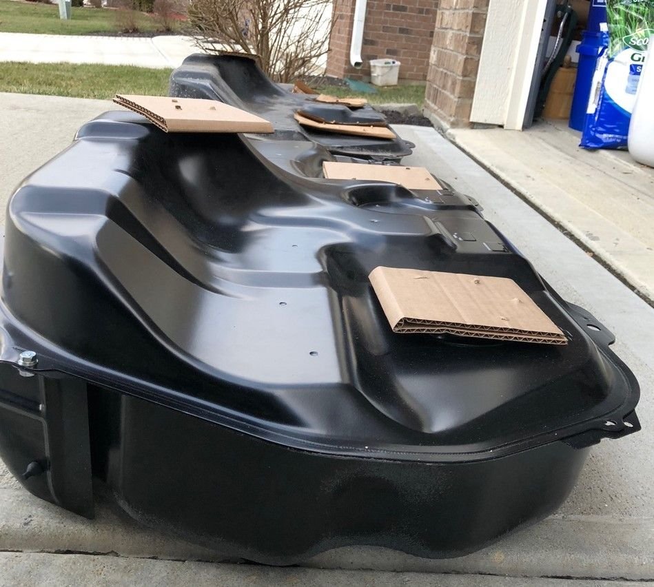

I've order a fuel tank from ears.ie (Ireland)
Was cheaper that others (cost me $550), and I assume its just like JDM in the photos above. But I will confirm what I get when it arrives. I will also make a video about it on my YouTube channel.
Not surprising, but i'm confirming the one from Ireland I received is also JDM.

I've been trying to get information regarding this too. It appears all the holes are there for everything to work just like oem. Can you transfer everything over? Or am I wrong in thinking this would work. Is the only difference the JDM tank does not have the fuel temp sensor?

Hope this does not cause a fitment issue...

Is the Earls identical to the USDM tank?
Reply 0
Mar 2, 2021 | 11:00 AM
Quote: Is the Ears identical to the USDM tank?
No. Its JDM.
Reply 0
Mar 2, 2021 | 11:54 AM
The bottom also curves differently probably to account for the RHD maybe? Hope that clears too

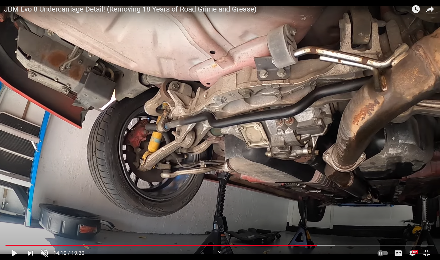

If I remember correctly the tanks general shape are pretty identical. I think the angle at which the picture was taken is making it look different. The only thing I can think that is different w/ the JDM compared to USDM in the rear is the rear diff being AYC which seems bigger in pictures compared to a USDM diff housing. The only other thing that is mounted in the rear in the JDM model is the AYC pump, which is mounted where the charcoal canister is mounted in the USDM. model. The fuel filler neck is also different on the JDM model bc of the absence of the charcoal canister.

I'm assuming the portion where the fuel temp sensor would go is blocked off. But the jdm tank looks like it has a fitting for something?
