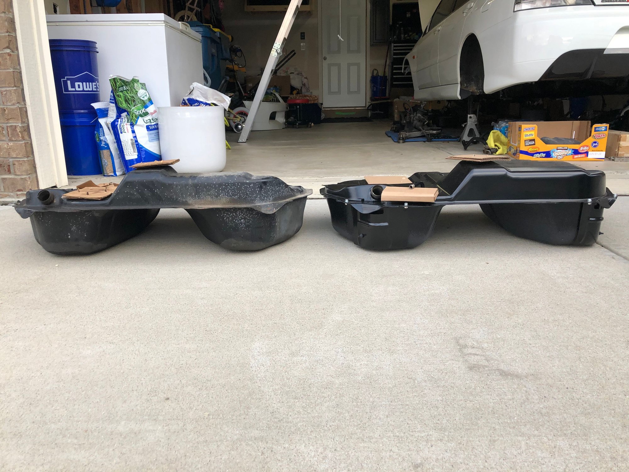

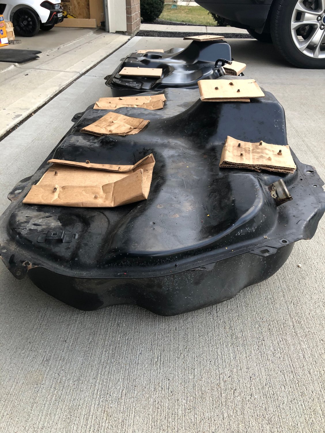

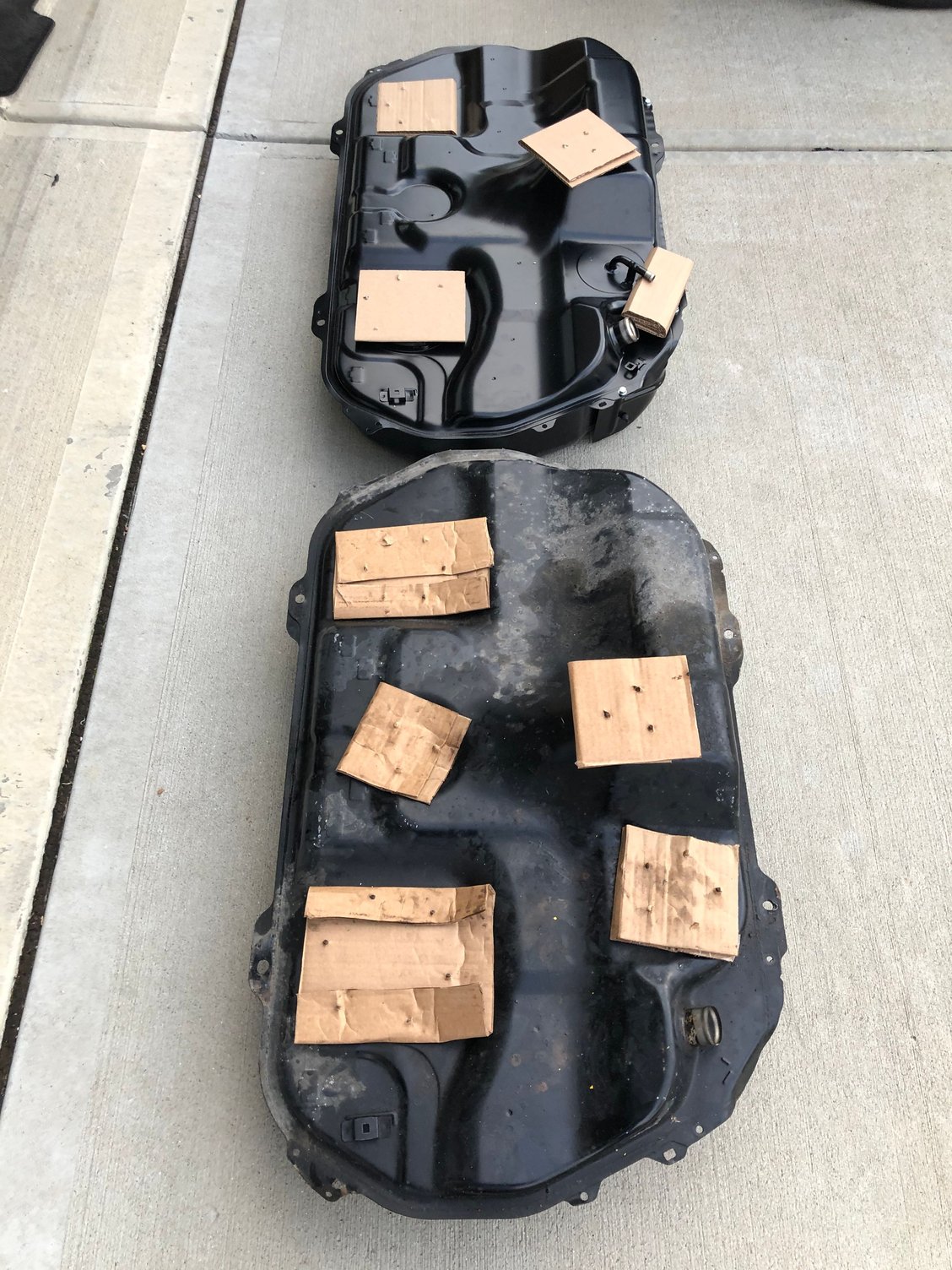

JDM tank on top vs USDM tank on bottom
USDM Left vs JDM Right
JDM Bottom vs USDM top

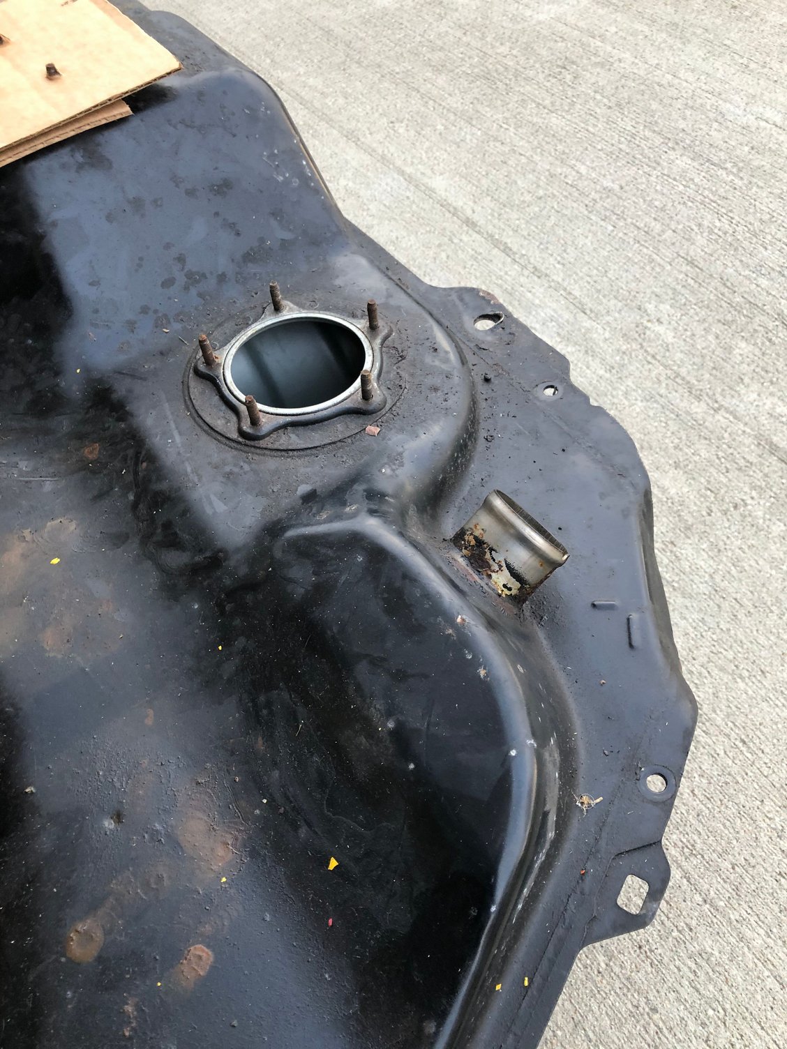

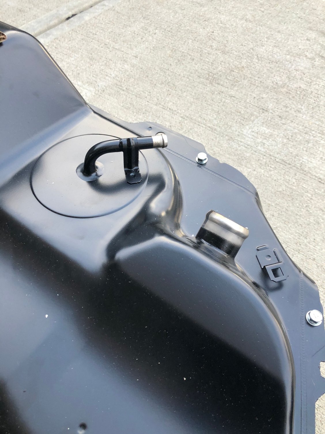

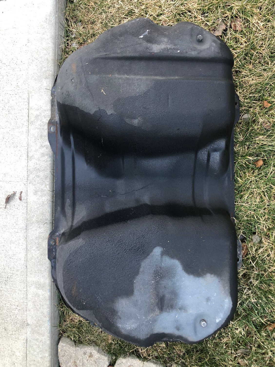

JDM Tank
USDM Tank
Bottom side of JDM Tank
Bottom side of USDM Tank (I removed the rear tank protector sheet metal)

thank you very much for the pictures now I need to find someone who has mounted it and made this happen already I don’t plan on putting a stand-alone in my car any time soon so I’d really like to find out more about it , btw guys this guy above me has a really nice build going on should check out his content
