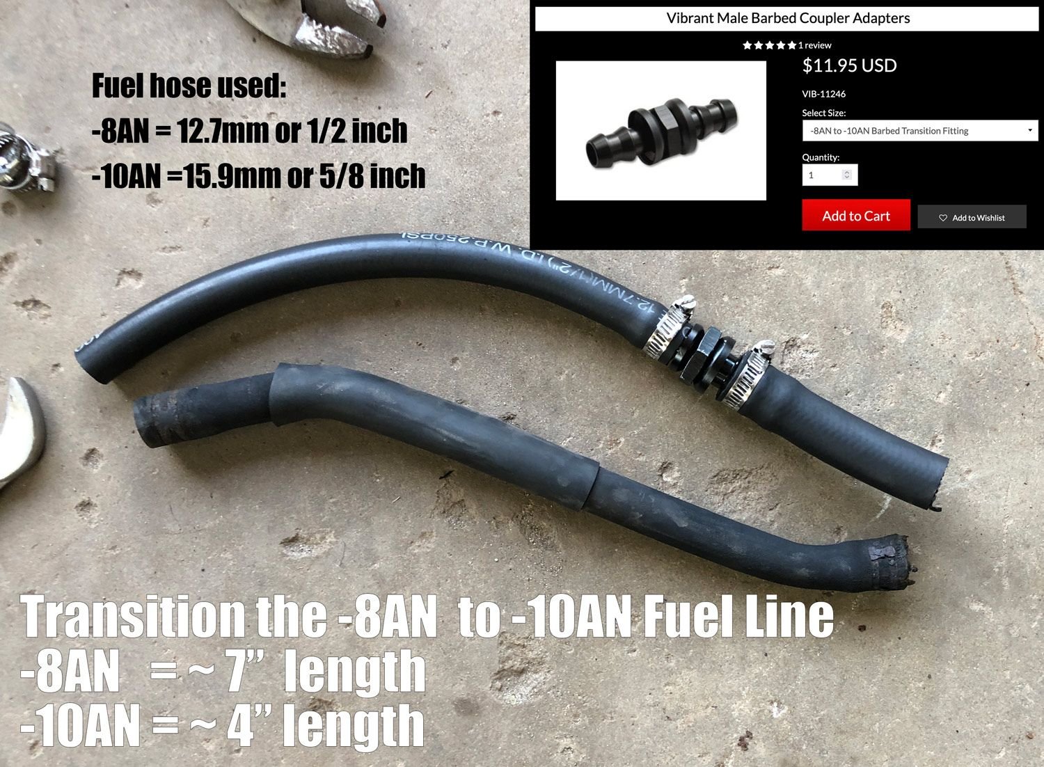

Info on the photo:
the top hose is the new one i created.
the bottom hose is the USDM OEM piece.
Here is the one thing you will need to create to make the jdm tank work in a USDM car.
-8AN fuel hose (about 7")
-10AN fuel hose (about 4")
a male barbed coupler adapter (-8an to -10an transition)
As long and your overall hose length is about 11-12 inches, the actual length of each size hose should not matter too much. But above is what i did.
This is probably also overkill since it is basically just a breather to let air escape as you fill. But I used all fuel lines just to be safe.
