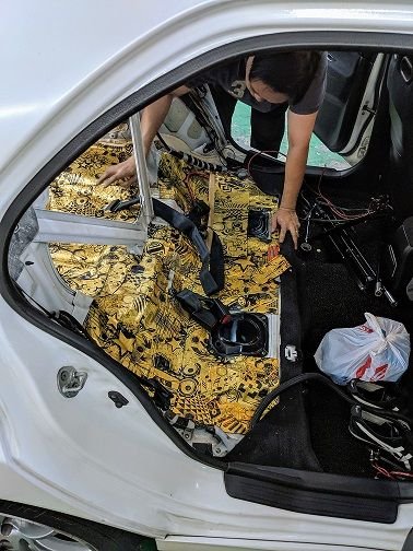

I was pretty puzzled at first so I asked if he did any sound deadening which he did but only for the doors. On the other hand I did sound deadening all four doors, below the rear seats and lined the whole trunk!!

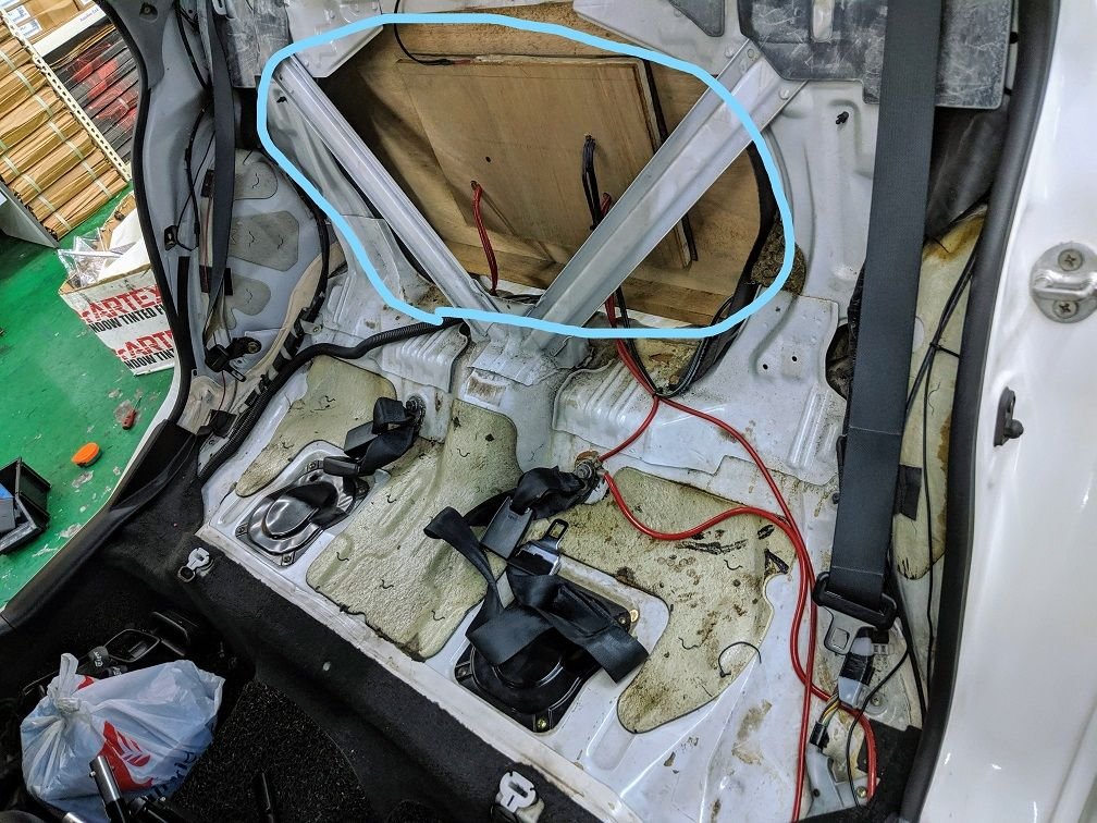

On hindsight, I saw that I had a custom rear seat plywood partition done to mount my amplifier (done by the previous owner). Now I was thinking if I added sound deadening material to that partition, do you think it would help further reduce the drone? I've also considered adding material to the trunk lid itself. I was tapping around and noticed that the trunk lid does sound rather hollow.

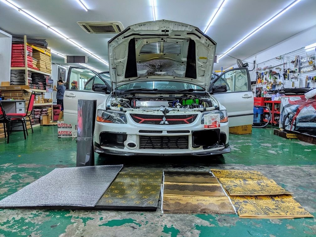

The materials used for the sound proofing
Entire trunk and below the rear seats were sound proofed
This is the rear seat partition I'm referring to. Could the plywood be better insulated if I added sound deadening material??

As far as adding more sound blocking, instead of covering the whole trunk, why not slap a layer of mass loaded vinyl on the back of the rear seat.
Attachment 324002
It cut out a lot of the road noise from the trunk area on my X.
Also, that yellow stuff that you're putting on the rear of the car, that appears to be butyl. That is simply a weighed layer to stop flat sheetmetal from resonating/vibrating. There are enough shapes and spot welds and adhesives in the rear seat and trunk areas where there aren't any vibrations there. Butyl is more meant for doors and the roof, and even there you only need to cover 25% of the surface area, so you're throwing away money.
