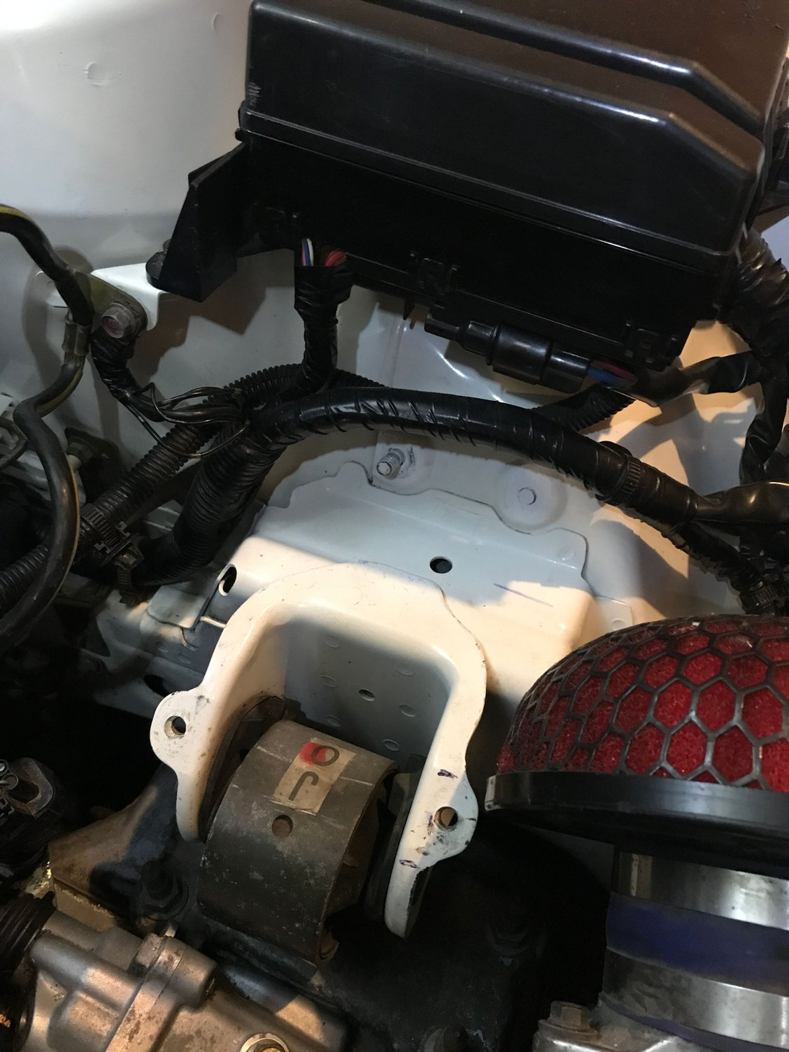

Broke body stud
What would you do in my situation?
I pulled out the janky battery tray the previous owner put in to clean and discovered one of the body studs was broke.
My original thought was to drill it out and use a bolt in its place but it is sandwiched between two pieces of metal so the opposite side is not visible.
I also thought about just grinding it down and secure the new battery tray with only three bolts.

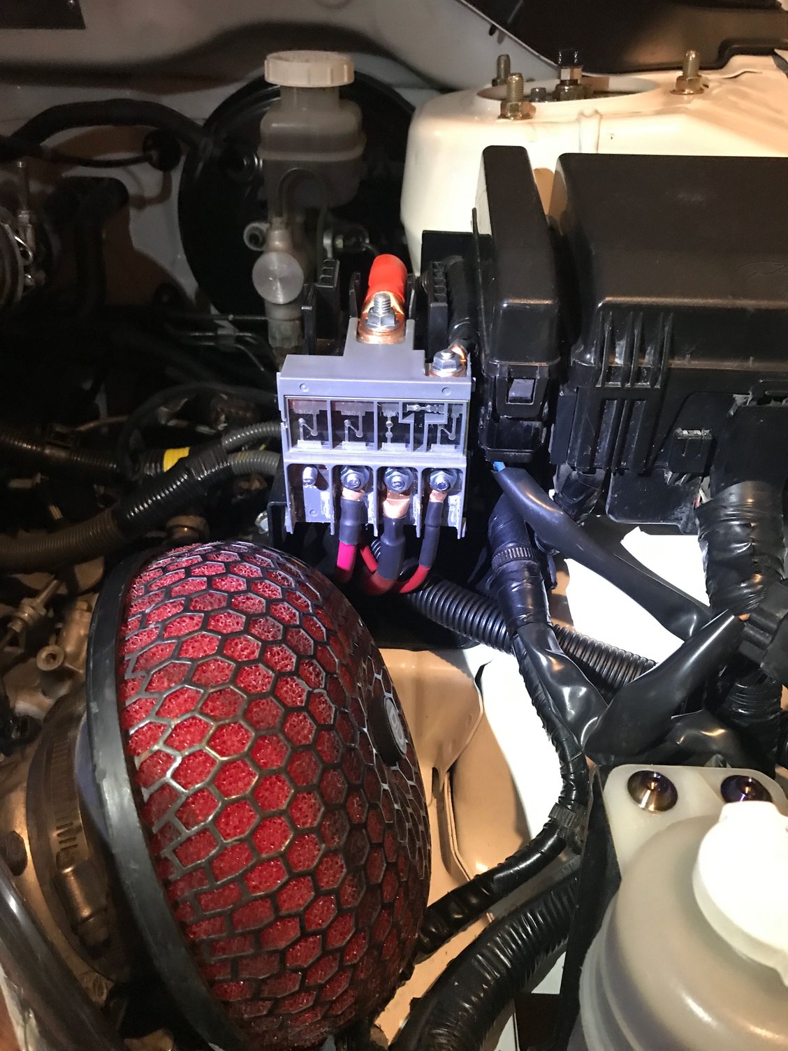

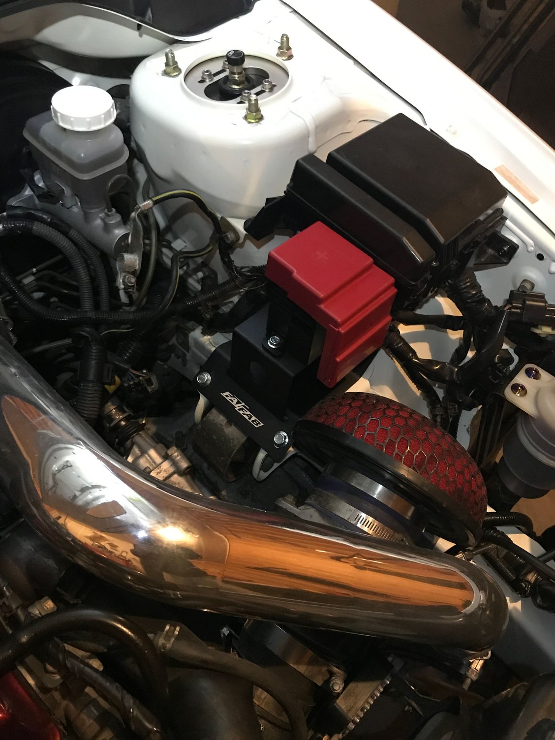

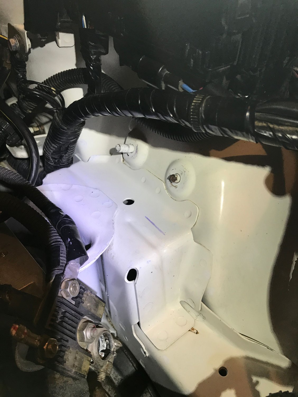

UPDATE:
Ground down the body stud and got some paint on it.
Then... Put the Fathouse Fab kit in. This weekend I'll get the battery cable and box in.

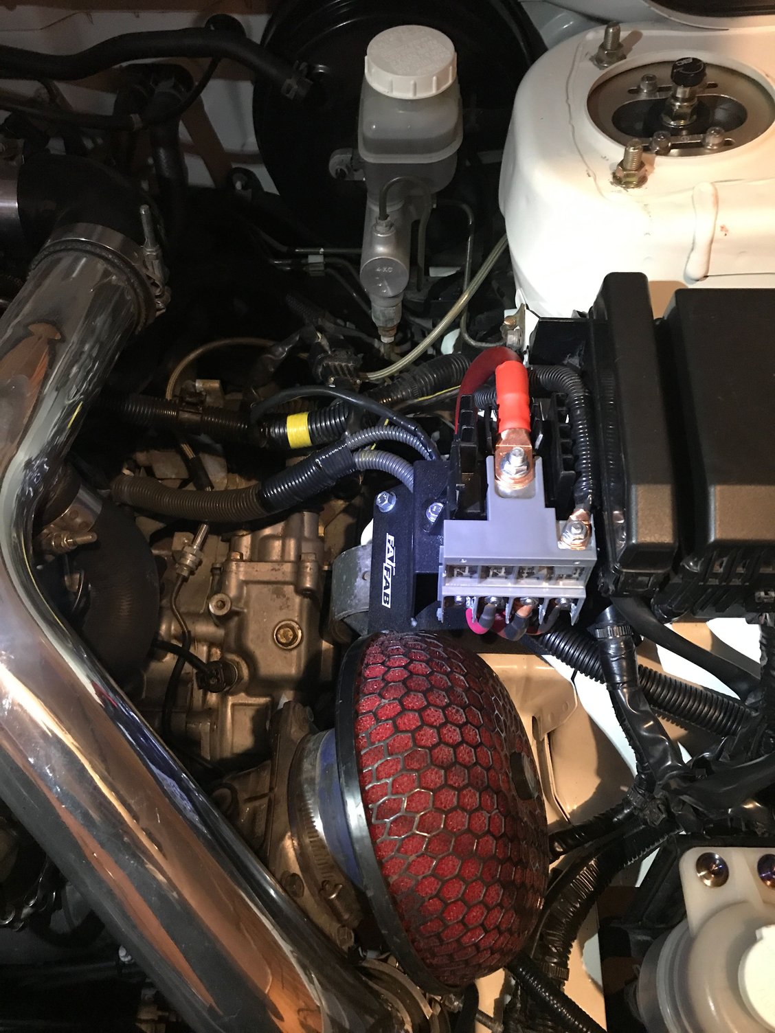

Finally got the engine bay all wired up.
Tomorrow I'll get the trunk wired.

Originally Posted by deylag
Which cables did you modify? I just happened to be getting around to installing one of these and it seems like a couple of cables need to be extended.
I had to extend all the cables but the one from the fuse box.
there are 3 different sizes, 4ga, 6ga and 8ga.
I ordered some butt splices from Amazon and got the battery cable from Oreilly's.
