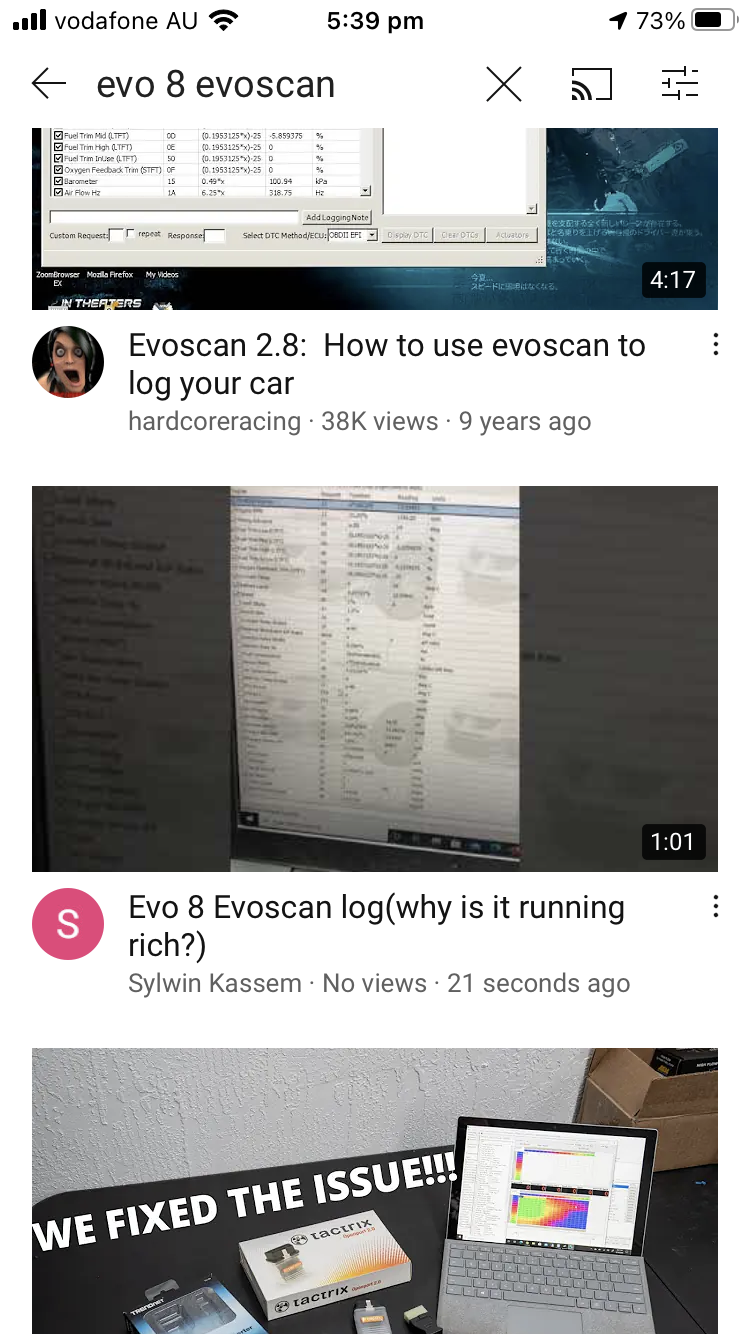

Old Feb 26, 2021 | 10:27 PM
cprevo's Avatar
Joined: Oct 2015
Posts: 28
From: Sydney
Posted my log on YouTube.
If it can be viewed and let me know if anything abnormal really appreciate it.
Screenshot below is the title name on Youtube
