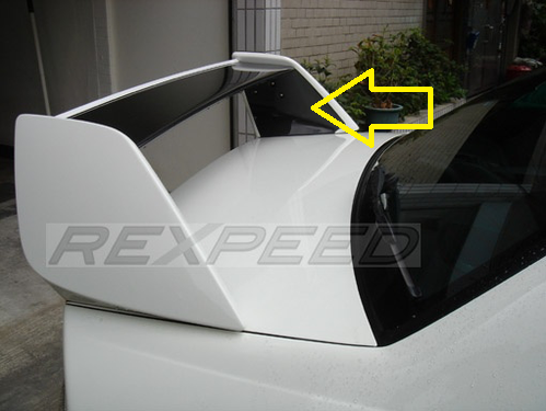

To gurney or not to gurney
I’m on the fence about picking up a rexpeed gurney flap for my 05 elec blue. Was thinking about the color matching version. Just curious what folks think about it…good looking or not so good?
Gurney flaps

Supposed to add down force. If you are a track guy why not. It’s not a mod that will break the bank.

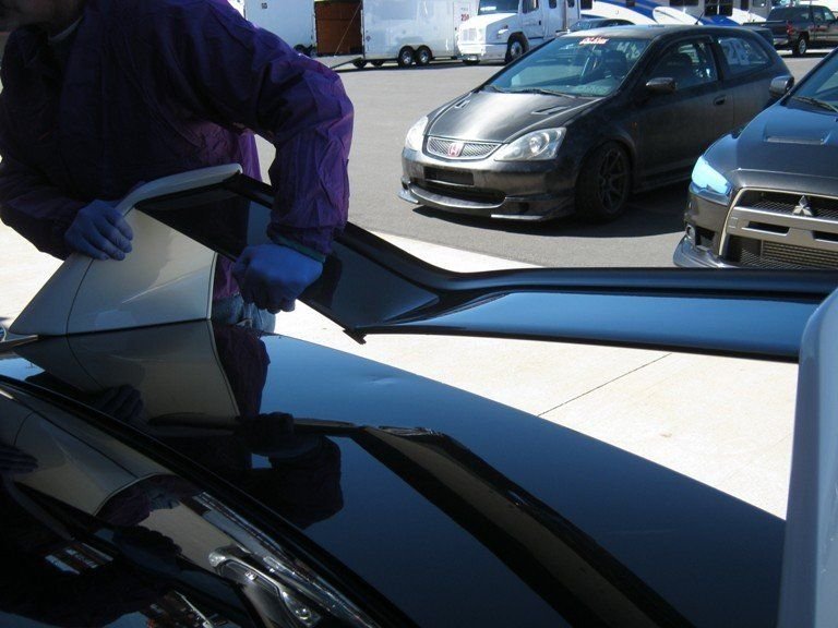

I used the EBAY one on my stock 9 wing & broke the wing in 1/2 on a track day
Here: https://www.ebay.com/itm/15320246210...wAAMXQiM5Q9jfU

adds downforce, but wouldn't do it on an evo 9 wing haha. i switched to an evo 8 wing and i use it there

Yep, your wing should be the hollow vs the foamed 8 wing. But for street use, you will never have that issue of overload
Heres was my damage (it snapped so hard, it dented my sweet black trunk as well)

Wow, looks like someone sat on it. That’s some serious downforce.

I had heard a few stories of guys breaking their 9 wings under air load but i really didnt believe it until it happened to me at Fontana. It was a gusty day & Fontana has high top speeds
I now have a true track day wing (APR)

I have one on my 9, came from the factory with the zero lift kit. No issues other than paint falling off. Its much smaller than the one Minus had.

Quite a few folks have had the 9 wing fold up under aero load. You could install a brace under it in the middle to fix permanently, But it wouldnt look stock. you might disassemble the wing and inject expandable foam into it but tricky for full fill.
If you are after the looks as primary and secondary some effect for the aeros, i'd get an 8 wing and add the gurney to it. Save the 9 wing for when you sell your car.
BTW i made my gurney from aluminum angle for my 8 MR wing on my 8 MR and used 3M tape extreme to hold , bent it to fit the slight rear radius of the wing. 3/4 in wide and 1/2 inch tall. No issues up to 130 mph. Tested by pulling as hard as possible to try to budge it. stayed put except when prying very hard with screw driver under it and that took quite a bit of prying
YMMV

Yes, add the G-flap if you like. its not going to do anything you will notice & we understand its just a looks thing for ya, so no problem adding that at all
