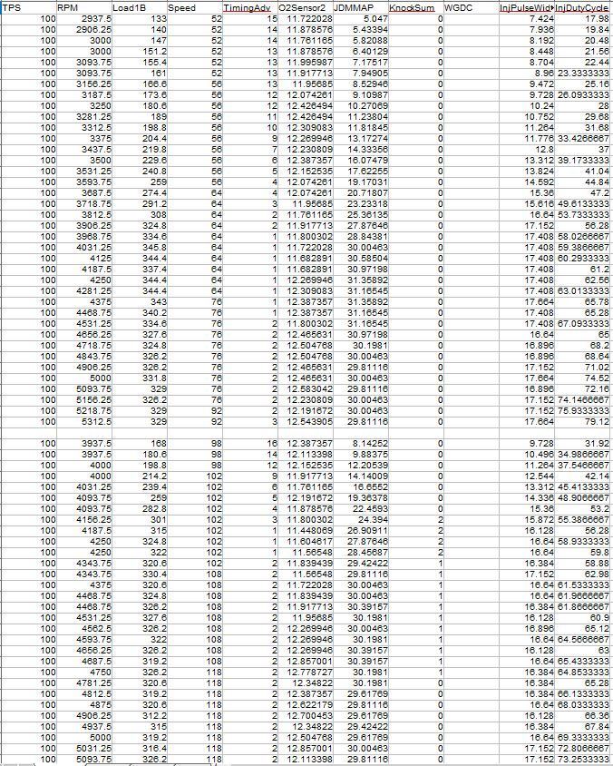

My car sat last year for a good 4 months. When I got around to driving it again I noticed fuel was tipping pretty lean into the 12s once I started hitting a bit over 4000rpm. Originally it held 11.6-11.8 pretty steadily at full boost with E85.
Here is what I've done thus far that resulted in no changes:
1. Replaced Walbro 255 with a new spare I had
2. Replaced FPR with an AFPR unit (since it was only slightly more expensive than the gauge alone)
3. Observed fuel pressure during a pull and it seemed to work properly at 1lb per psi of boost but it quickly falls back down once peaking
4. Replaced likely dying battery with new one, I have 13.8-14+ V to redline
5. Had injectors sent off to be cleaned/flow tested
6. Tried new fuel
7. New wideband sensor
Not really sure what's going on. Does the IPW look weird? Here is a log from a quick 3rd-4th WOT pull, I let off early for obvious reasons, it only gets worse the higher you go.

so you were seeing 71 psi plus on the fuel pressure at the top of the pull?
if so, looks like tune to me.
It turns out that the fuel pressure is quickly peaking with a 1:1 psi to boost pressure reading but then it sharply falls as the rpms continue to rise.
welp.. you found the issue then.
