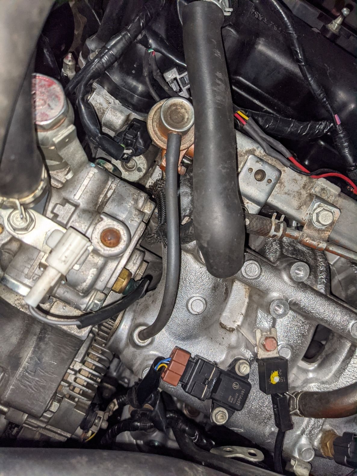

Thanks for the reply, I don't have a fuel pressure gauge right now (stock fuel rail, etc). Whatever it is, it's high enough that it keeps blasting off my fitting while I'm cruising . Here's a pic of my FPR:
Nothing clamping it down, but it's on there enough that I can't pull it off. Is it still a good idea to put some zip ties or something on em? As for the relay, I swapped my lowbeam (blue) and fp (black) relays, and they both seem to turn the lights on fine. Do I need to pull out the multimeter and do some sort of test on it?

You need to fix the high fuel pressure issue. I’ll put my money on clogged return venturi in the fuel pump housing.

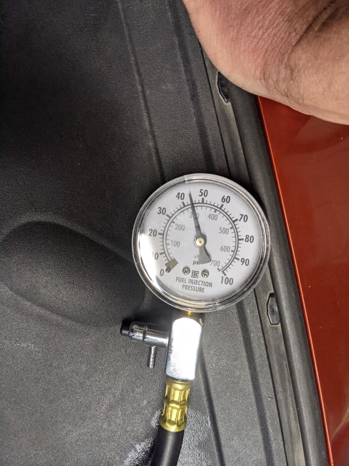

Pulled the pump out today, drilled out that hole and blasted air through every line I could get my mitts on. Seems a tiny bit better now, but could just be a placebo. Ran to the hardware store and grabbed a tester afterwards, everything looks good to me.
Only weird thing is when I had the key turned, it jumped up to 60-70 for a split second, idk if that's normal or not. Another thing I should mention is that I just noticed there's MASSIVE rev hang, not sure if that's relevant.
