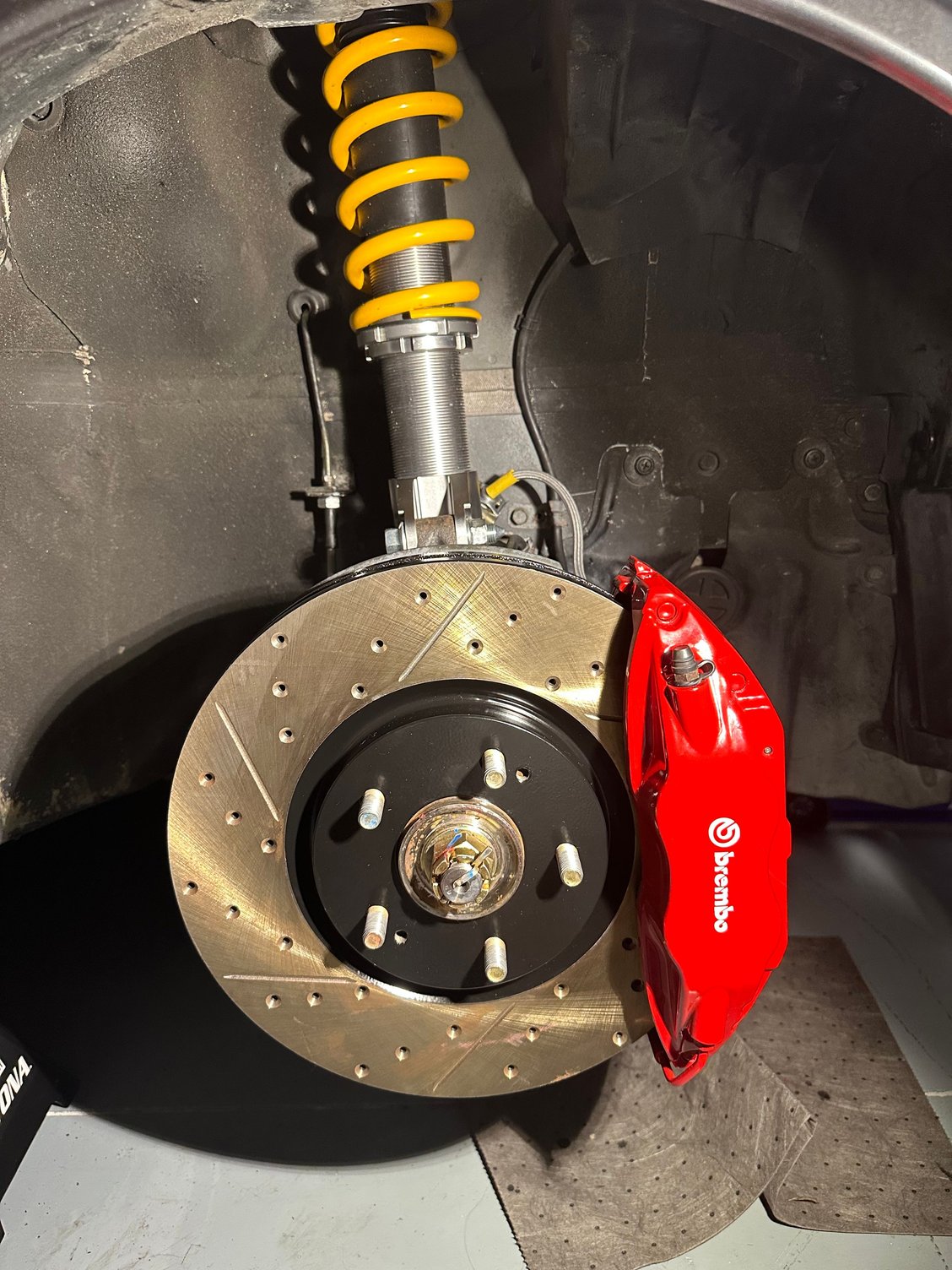

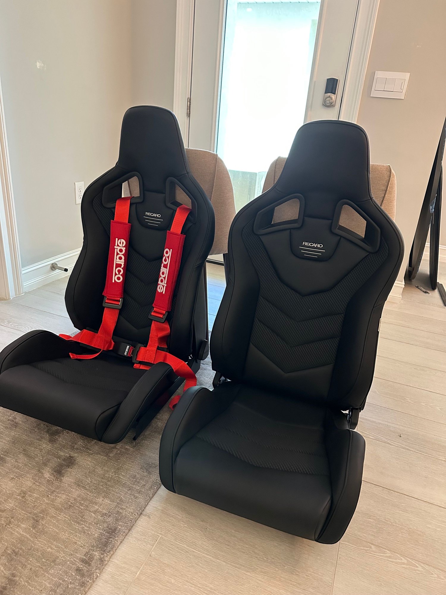

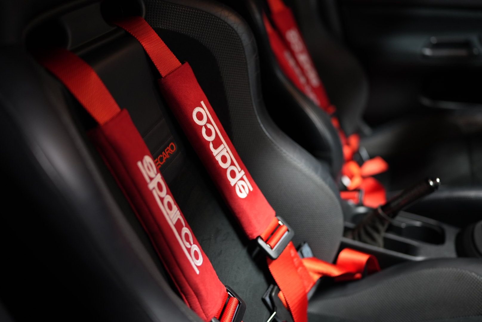

Hey guys- can anybody tell me what ohm resistor I need to get rid of this SRS light when installing aftermarket seats? I have done some searching and the threads are all very old, and there is a lot of debate.
I also cannot for the life of me get these rexpeed mirrors to work. The passenger mirrors are moving left to right only and the driver mirrors wont work at all. I have seen many threads on these and everybody seems to get them working with the wiring recommended on here, but mine wont take. no fuses blown as far as I can tell. I am stumped. Rexpeed told me basically to check the wires and make sure they match the sheet they provided, which makes ZERO sense haha!!
Here are some more progress shots!

No Airbags in the seats so no resistors are needed.
Also the belt buckle plug is just for the dash light and warning. You can disconnect that too, no issues and no lights.

thank you I appreciate that! Unplugging the seat buckle wire worked great - no ding or anything which is fantastic.
however when I removed the front seat belts I seem to have upset something. SRS light in dash. Assuming I can just plug a resistor into the little yellow plug where the seatbelts connected. I assumed it was an airbag sensor. It was connected to the bottom of the seatbelt assembly. I wish I took a pic. I’ll have to do some more research but it sounds like just a resistor should do the trick.
not a ton of progress today but did get some new pads, rotors, and brake lines in. Also replaced all the lights with some LEDs. Much cleaner.
more to come!
