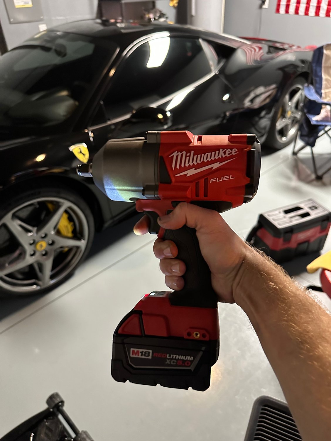

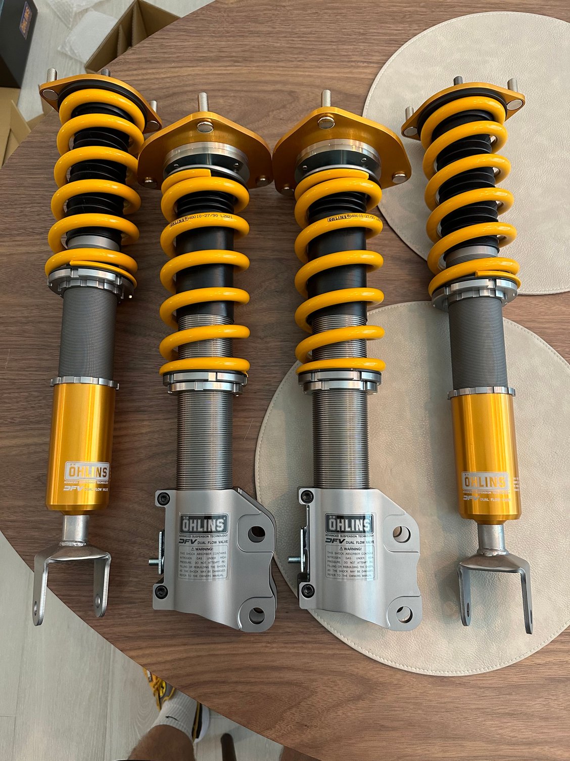

Today I threw on the coilovers and front brace as well as some minor interior bits. Got pulled over 5 minutes after getting it delivered this Saturday because I drove it 1/4 mile without a plate. So stupid haha!! Just a few pics to share. Haven’t adjusted the ride height yet because wheels are en route but it’s sitting nicely for now.
also attached a pic of my new favorite impact. I never thought battery would compete with air (still doesn’t IMO) but my god that thing is an absolute beast. I don’t have a compressor in my little garage at home so decided to give it a try. Broke these semi crusty and oxidized 17 year old bolts free immediately without a single issue. All hardware in great shape.
all and all a good day and great set of coilovers. Highly recommend.

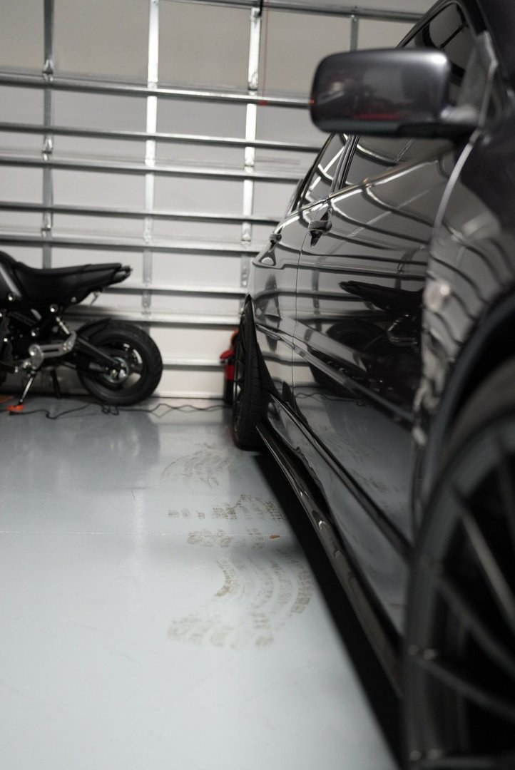

Before lowering. Looked fantastic in the light.
Ohlins coilovers on stock wheels.

The window tint , also have the same Milwaukee, awesome impact lol what percent is that, I feel like im darker than you at 2 percent haha heres my tint

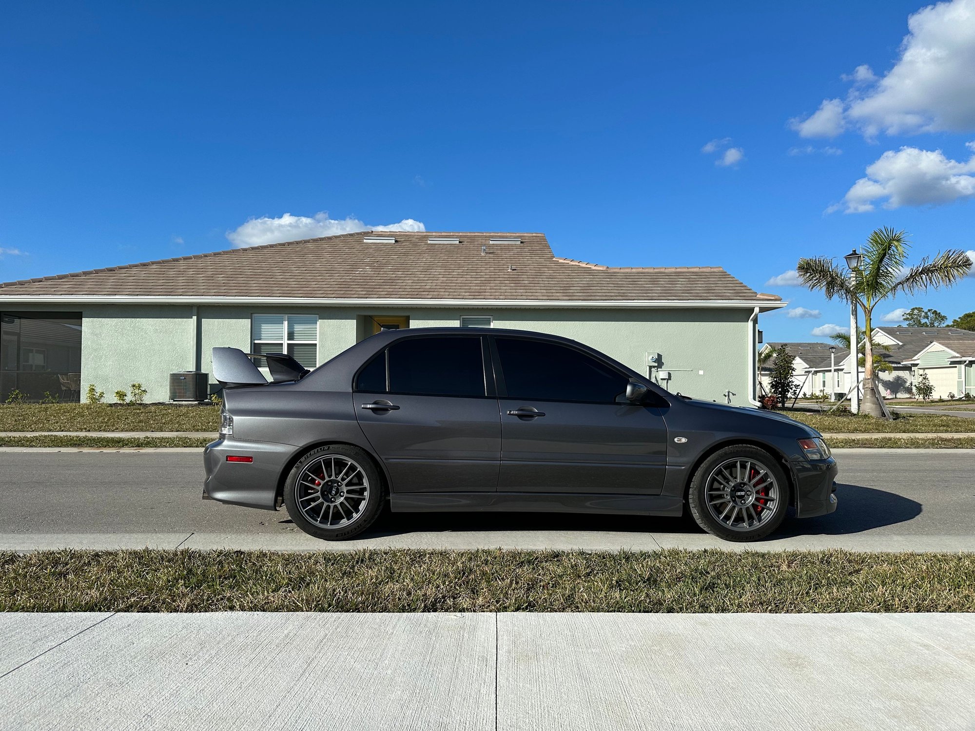

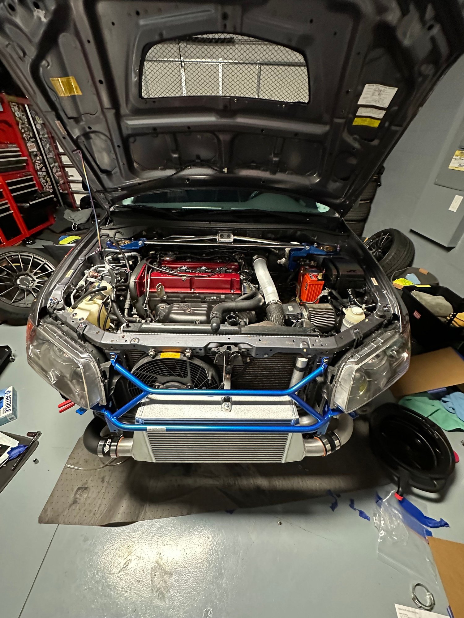

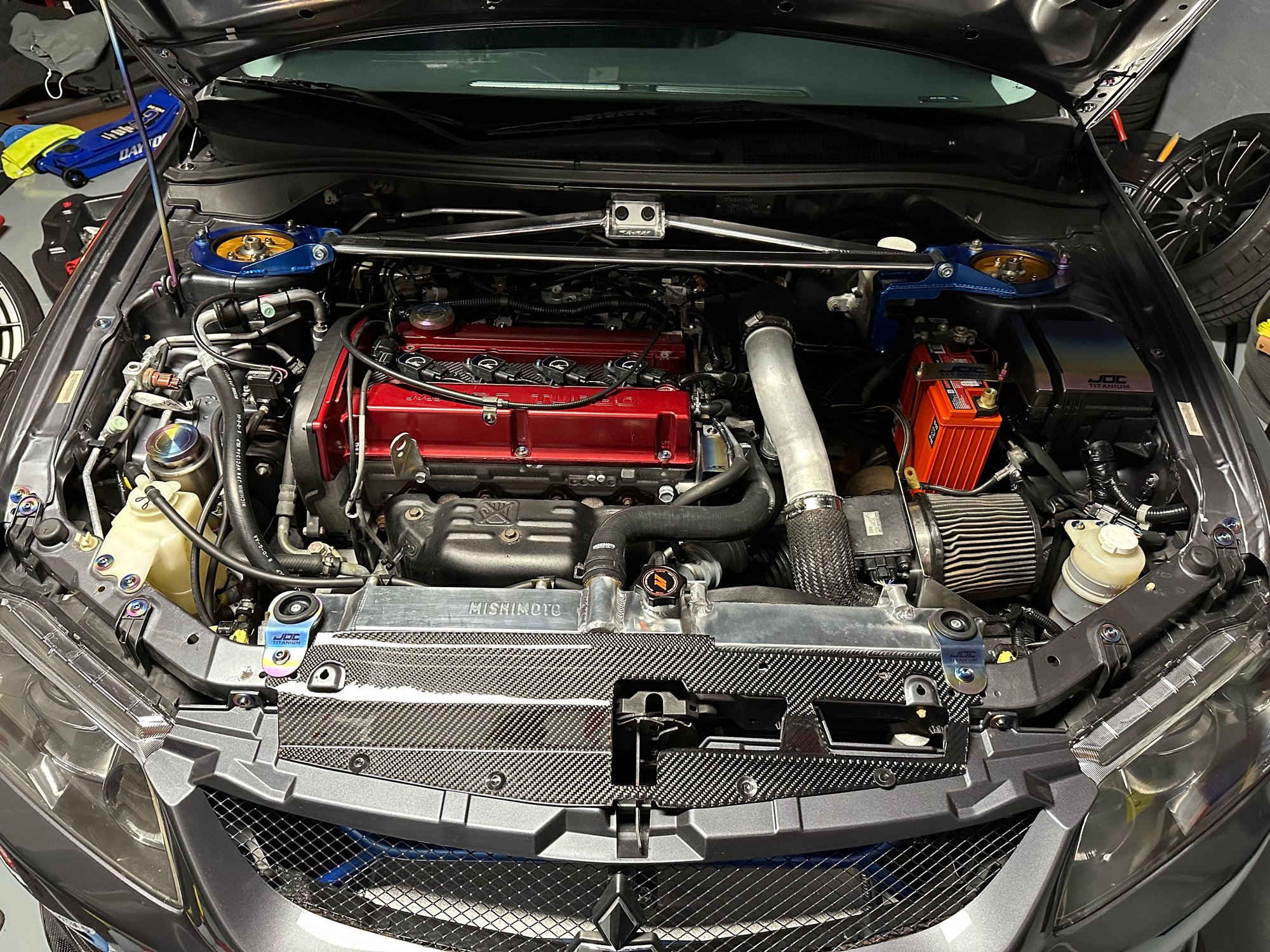

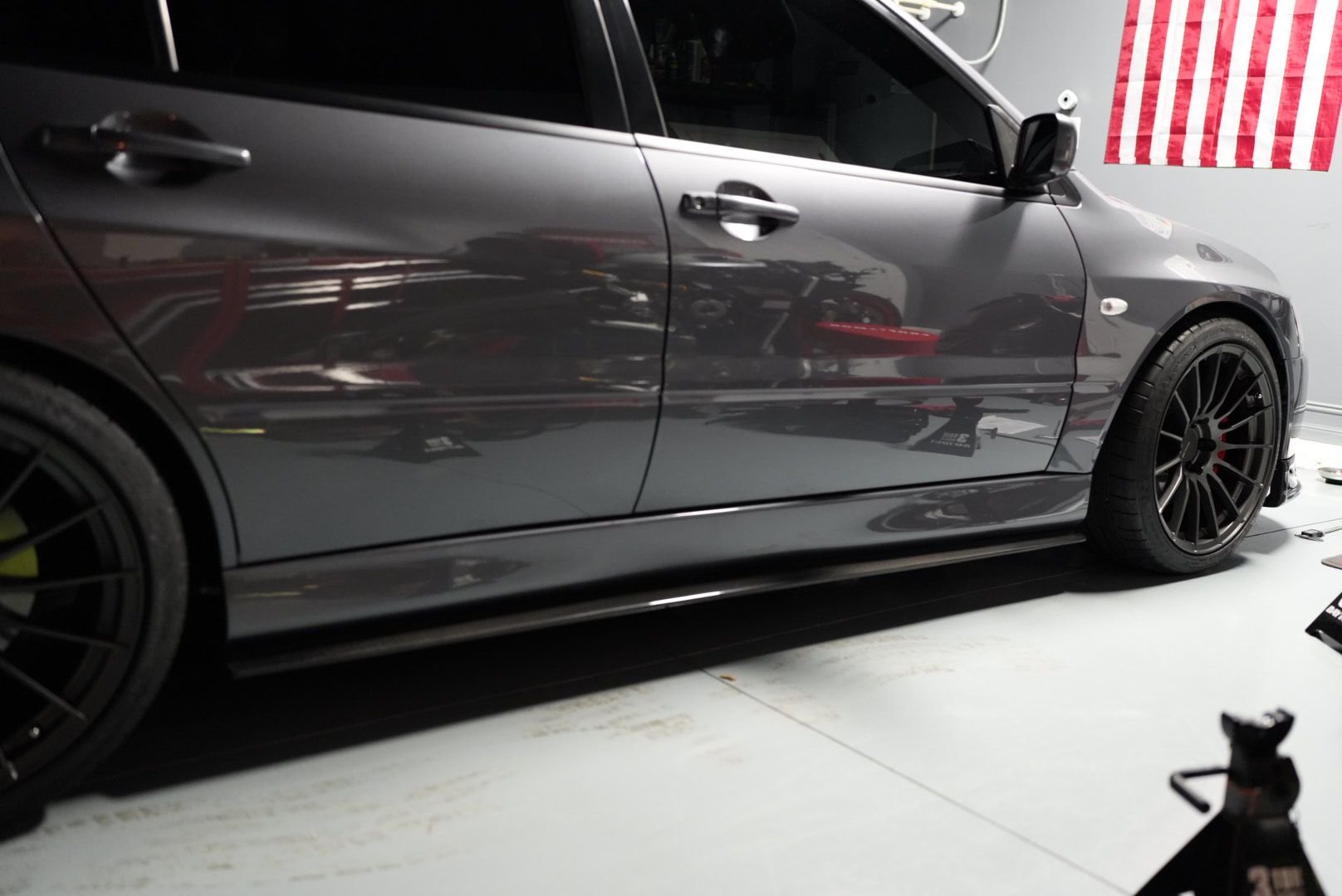

Hey guys - I know its been a while so I figured I would post an update. Over the last couple of weeks the following went on / was replaced or updated:

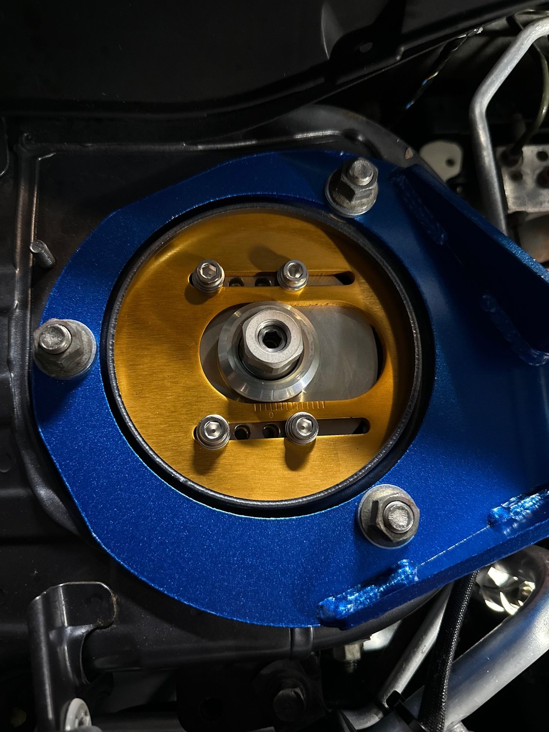

  • Ohlins coilovers. I am honestly not thrilled with these. I set them up at 199mm preload on the springs they provided and maxed out the bottom threads and they don't go very low. I have several emails into them and have yet to hear back. They also arrived damaged / the rear adjuster knobs were broken. Also not enjoyable essentially having to take them off the car entirely to adjust ride height (in the front at least)
  • Cusco power brace / cusco front strut brace w/ brake stop. Brake stop feels weird - may take it out but we'll see how it goes after the brake job
  • Enkei wheels - I like these! 18 x 9.5 +22 - rubbing in the rear but haven't touched camber yet. Ordered from fitment industries and they came damaged. Huge chunk missing on one of the faces. They offered me a replacement wheel for $500 and acted like that was in some way helpful? LOL - stupid. I will be ordering custom wheels soon though so whatever. Still not a great way to run a business but oh well! Wont ever use them again.
  • Rexpeed sideskirt extensions, ebrake handle, cooling plate, and front lip - solid fitment and finish. Carbon appears to match quality of some really nice brands in the Ferrari tax world that would charge thousands if not tens of thousands for similar pieces. Really nice stuff. decided to order another rear trunk spoiler to test fit it with the wing.
  • Mishimoto radiator + fan - fitment is good. It was hitting what appears to be an oil line or water line so I need to look into that but no leaks and overall super happy with the look of it. Fans spin on quickly as well.

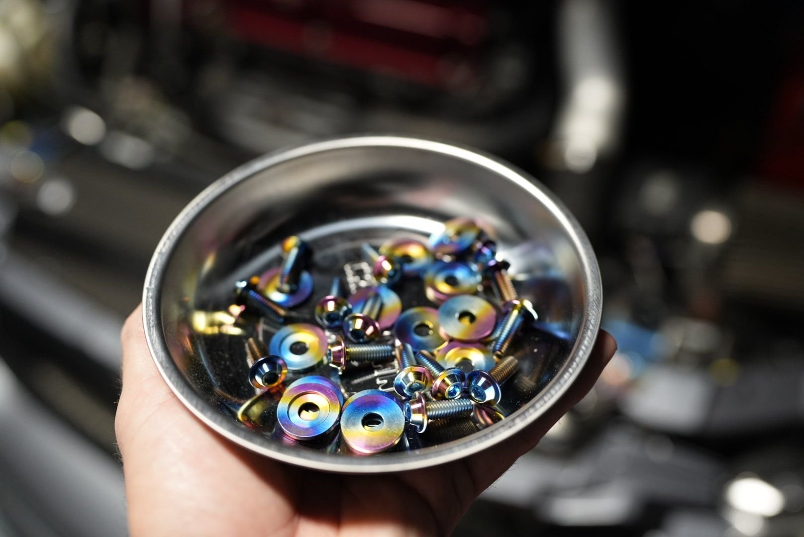

  • JDC titanium engine bay hardware kit, hood prop, fuse box cover, and a lot more misc pieces
  • JDC ignition system - looks freaking amazing and sleek - still some engine cleanup to do when the other parts arrive
  • JDC reservoirs - yes I am going very rainbow with this build LOL (its called time capsule for a reason!!!)

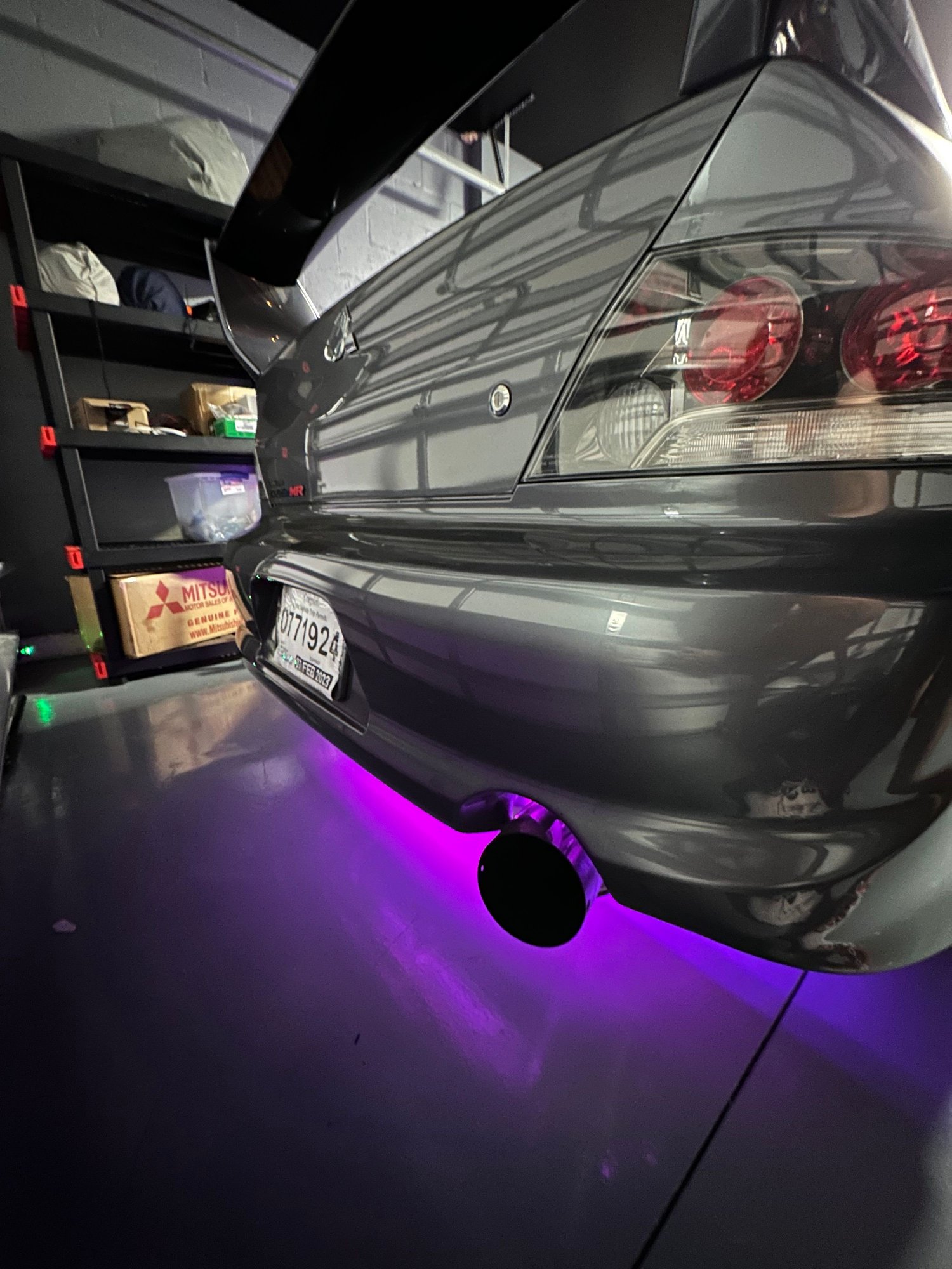

  • TYPES underglow - I wasnt about to buy my high school dream car and not put underglow on it. This stuff is awesome.
  • OEM window trim- by far the most drastic 'restore' part thus far. Completely cleaned up the exterior look with the tinted windows. So thankful they still stock these! I will probably buy another set for when these go bad. Might try to ceramic coat them but that weird soft touch stuff is really needy
  • JDC mini battery tie down + smaller battery
  • New floor mats (they go so far)
  • JDC titanium shift knob
  • FMIC + lower intercooler piping
Much more to come in the next couple of weeks:
  • Seats
  • Harnesses
  • charge pipe
  • brake rotors, lines, pads
  • intake
  • BOV
  • speed density
  • exhaust manifold
  • turbo? still haven't decided - tuner recommended FP black for my goals (425-450, quick spooling, reliable clean idle)
Fuel pump was making some really aggressive whining noises and then a cel after about 45 minutes of driving. I see this is pretty common. Don't know what fuel pump the previous owner had so I ordered the walboro 255 to see if this helps. Car is currently on jack stands until wednesday when I can get a new suspension bolt. No clue what the PO did to this bolt but it was ballooned out so badly that it actually put a hole in my new coilovers on the front strut mount. So frustrating but new bolts on the way! I will get it out for some better pics then!
Cheers & thank you all for following and for suggestions thus far.
