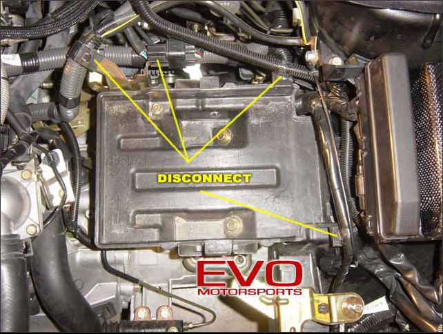

Hey guys, does anyone know where does this bracket go? I believe it belongs somewhere under/behind the battery or close to the links for the shifter on top of transmission. I cant remember where and exactly where its suppose to bolt on to. Any help would be greatly appreciated
I know it connects to the harness of positive battery terminal, just not where it bolts on to.
This one goes underneath the battery tray. As seen in this orientation.
Mitsubishi PN#: MN124350
Link to article for reference picture:
https://www.evomoto.com/tech_article..._article_id=27

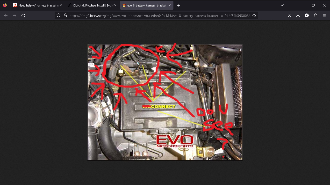

bracket location
your looking right at it my dude, very left yellow line, the black part of the bracket is upwards holding a harness and the other bare sides of it are pointing downwards and away from you if standing in front of the car, the harnesses have a slot on the bottom and will slide onto the brass tabs and click on securely. oh and just my 2 cents but while you got it out take a wire wheel to that s.o.b. and shine her up a little bit

bracket
this help? lol
Awesome! I will try and see if I can figure it out tomorrow. The picture really helps, at least I now know which direction its suppose to be facing because its a bit kind of a mess back there. Thanks!

Originally Posted by BlackOZ_24
this help? lol
lol yeah, I got the memo. Will attempt to reinstall it tomorrow. Appreciate it!

itll be easy bro just make sure the black plastic holder is up top oriented where it can hold the battery cable going across the back of the battery tray there. and the other 2 plugs will have those slots. if you ever doubt your memory take pictures with your cell phone. at work when i run into something i havent wrenched on yet ill do this if, especially if i have to finish it another day or something. and your welcome, remember its just nuts and bolts aint nothin to it but to do it

lol that was when I was about to drop the trans to change the clutch but I managed to get the bracket back on, it actually bolts onto the battery tray, mine was a little bent so it was a little awkward looking.
