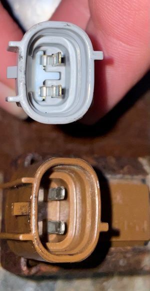

Hey how are yall doin, I recently bought a Grimmspeed Ebcs for my Evo 8, I might be stupid or something lol but long story short it seems as if it has a different fitment than the oem boost controller. Im just wondering if it looks like I got sent the wrong fitment or Im making some sort of mistake thanks in advanced
Edit: Grimmspeed said they had a small batch that came assembled incorrectly and said I can replace it or just cut the notch off myself

it looks like the pin is different on the right side, check the harness side to make sure it has the notch
