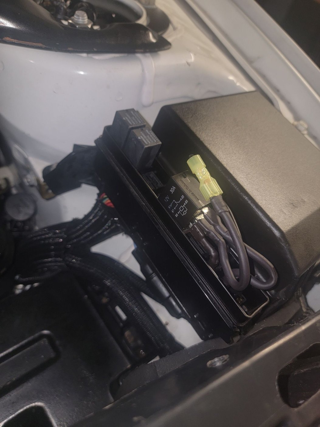

I had to rewire my starter relay to make my small weak battery be able to start my car. I have only tested battery-connected/not starting the car for a week tho

I remember going down this path. I think we did the same thing, where we had to wire in a relay triggered by the OEM key start signal to create an additional direct current path between the battery and starter. I never had a small battery, but I wouldn't put them in anything except a track car lol

yup, mine has no cuts and uses the OEM relay
